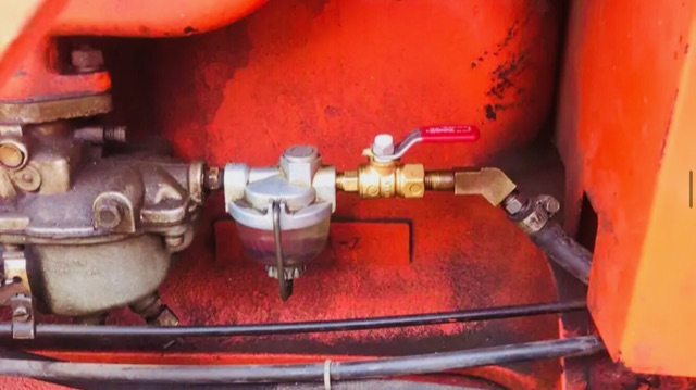

I also always put a can of Seafoam in my 170 whenever I gas it up. Helps keep the needle and seat clean. Also recommend an inline filter before the sediment bowl. I added a ball valve shutoff because the one under the tank is not easily accessible. I used a Legend 101-520 1/8” T900.
