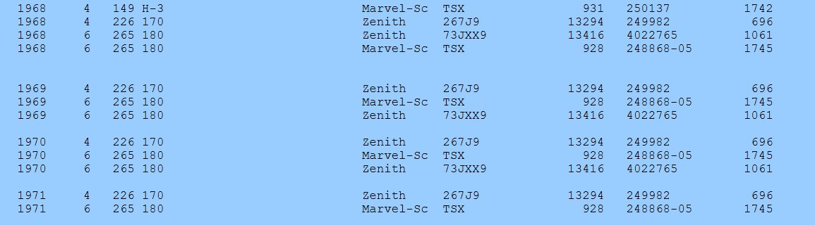

What is the Zenith number carb on 170? I don;'t have my manual, can't read the numbers on carb. It needs a gasket kit.Thanks, Tracy
Points: 12071
Post Options Post Options   Thanks (0) Thanks(0)   Quote Steve in NJ Quote  Post ReplyReply Direct Link To This Post Posted: 03 Sep 2025 at 6:11pm
Hey Trace!
According to my book, the 170 is equipped with a Zenith P/N 13294 (or AC # 249982)
Steve@B&B

I got the old girl running again. It was really gummed up. I will get a kit and install later. I really didn't like how float needle seemed to stick. Has a rubber tipped needle. Thanks, Tracy
