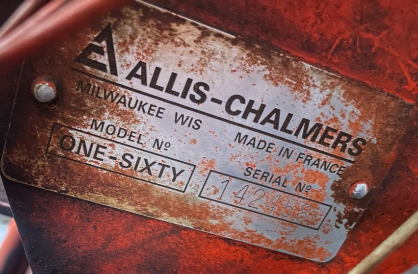

Working on a 160 to get it back up to snuff.
Has a bunch of leaks and it pops out of 5th and 6th gear going down hill. Not too worried about fixing leaks as the popping out of gear could mean an impossible search for gears.
Parts seem to be kinda hard to find for those tractors…
Thinking it’s an early model from looking at it.
Haven’t dug into the trany yet due to weather being cold and no heated nor insulated shop but next week looks promising.

Unfortunately these 160’s/One-sixties are hard to get parts for. Great little tractor though
Points: 5489
Post Options Post Options   Thanks (0) Thanks(0)   Quote AC720Man Quote  Post ReplyReply Direct Link To This Post Posted: 02 Feb 2026 at 10:09pm
Is it a letter tractor or a number tractor? One-Sixty or 160. Letter tractor is the early model.

Post Options Post Options   Thanks (0) Thanks(0)   Quote 55allis Quote  Post ReplyReply Direct Link To This Post Posted: 03 Feb 2026 at 10:26am
It’s an One-Sixty so it’s an early one.

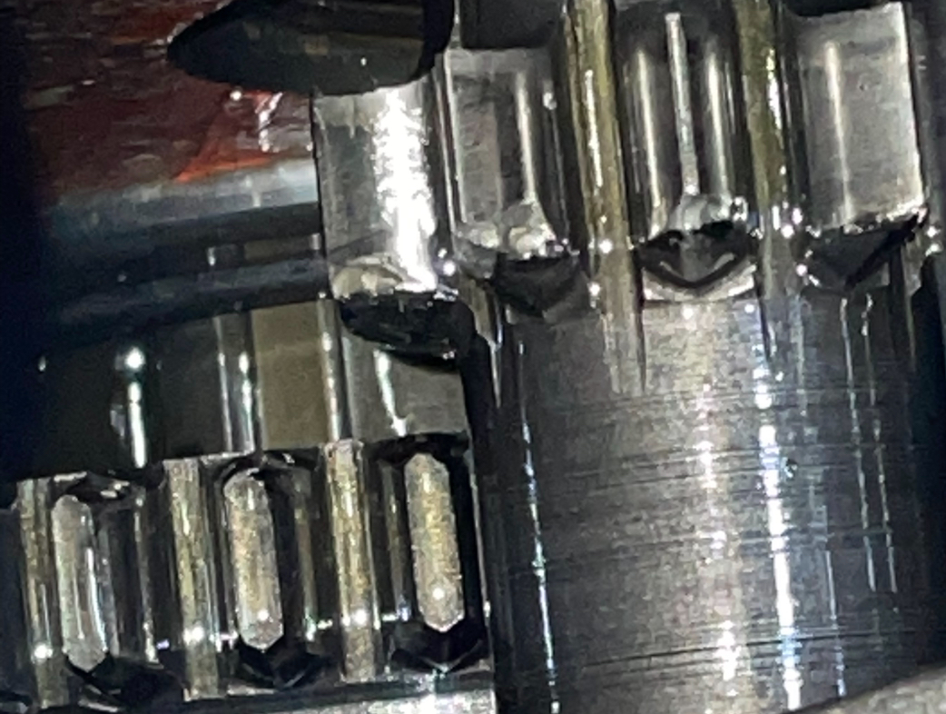

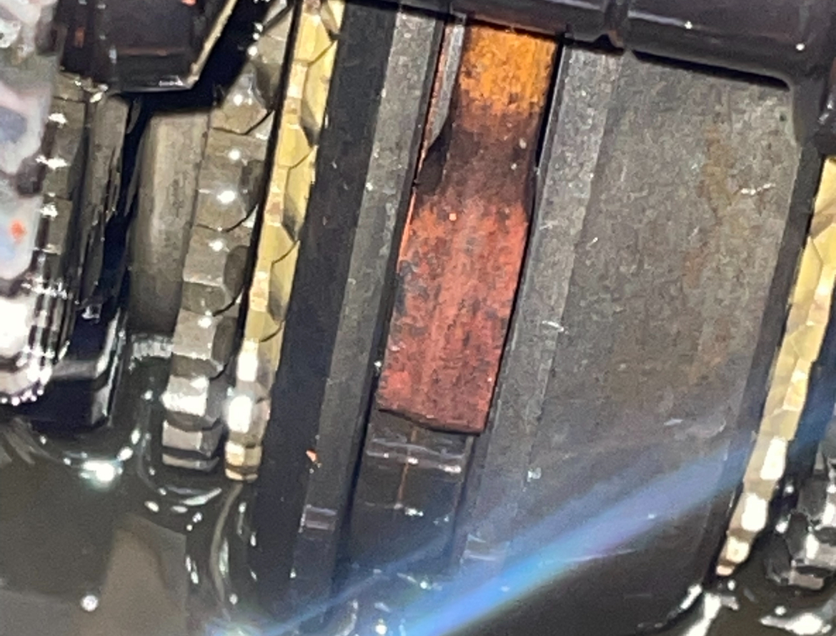

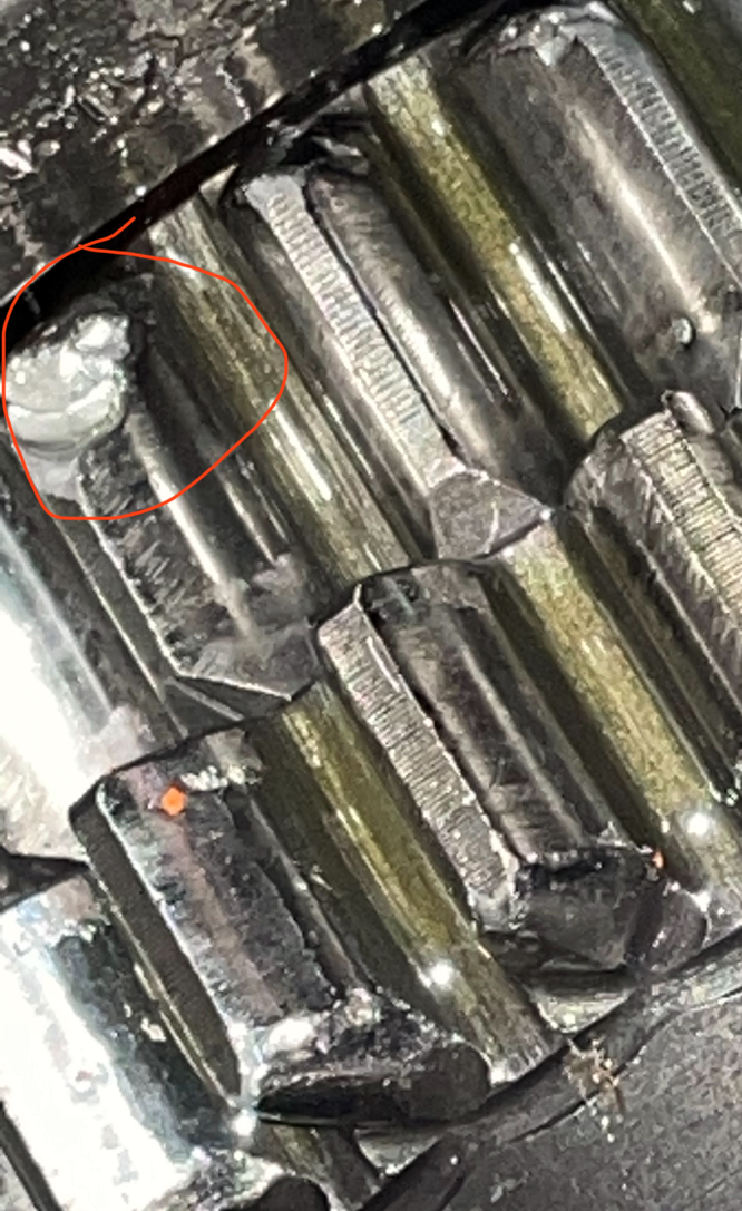

Post Options Post Options   Thanks (0) Thanks(0)   Quote 55allis Quote  Post ReplyReply Direct Link To This Post Posted: 05 Feb 2026 at 3:25pm
Pulled the shift tower off and not liking what I seen…
Chipped gear teeth and a gallon of water in the bottom…
Did get it to pop out of 6th gear down a hill while pulling back on the throttle.

Post Options Post Options   Thanks (0) Thanks(0)   Quote Les Kerf Quote  Post ReplyReply Direct Link To This Post Posted: 06 Feb 2026 at 4:10am
She's been rode hard and put away wet a few times too many for sure! Shocked
Points: 5489
Post Options Post Options   Thanks (0) Thanks(0)   Quote AC720Man Quote  Post ReplyReply Direct Link To This Post Posted: 06 Feb 2026 at 4:24pm
Wow, that’s what I call grinding gears!!! The result of shifting on the fly in a partial synchronized transmission.
