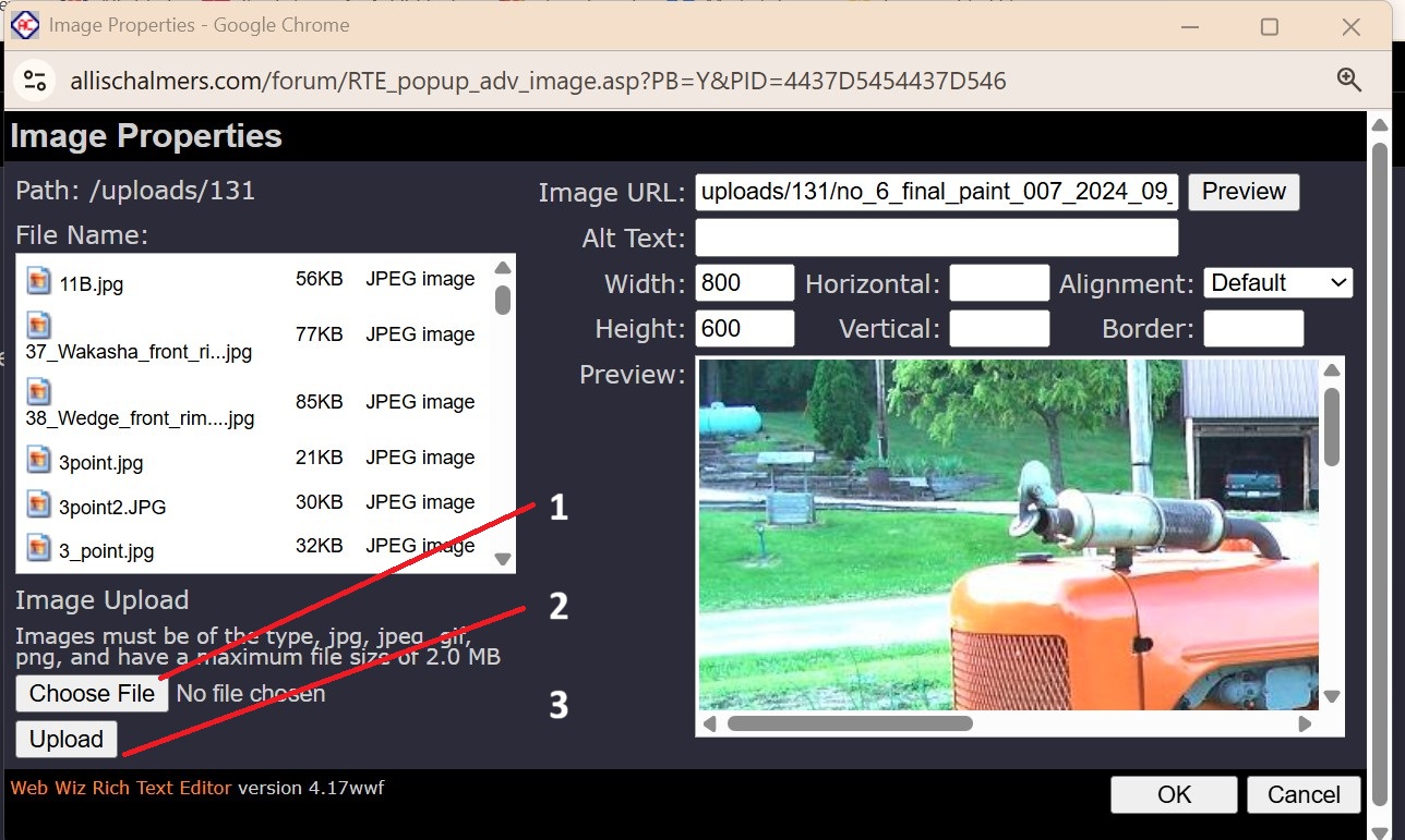

Leadoff, I do have a few photos from the dealers ad, but do not know how to post them on this site, since I’m a rookie here. Can you give me a few tips?
I am keeping this under my hat from my wife at present, I’ll bet a few of you at least are familiar with this tactic. No use having perhaps a months’ worth of discussions on the matter when I can just buy it, pay for it and inform her after the fact. It’s over in one hour then. Ask for forgiveness, not permission. One of the strategies learned in 44 years of marriage, works for me.Clap
Points: 90239
Post Options Post Options   Thanks (0) Thanks(0)   Quote steve(ill) Quote  Post ReplyReply Direct Link To This Post Posted: 3 hours 7 minutes ago at 9:13am
at the bottom of this post, on the left side, is a BOX that says  "POST REPLY"... Click on that and you will get another pop up page.... Look for the GREEN TREE ICON on the heading of that page... Click on that and you get ANOTHER POPUP that you can search your Photo Files on your computer or phone.... upload from there.
Click CHOOSE FILE ... then pick the file
Click on UPLOAD ---- your photo will apear on the right
Photo must be under 2 MB to load... change size to 800 x 600 to fit this SITE
Post the photo with the "OK" button on the lower right.
