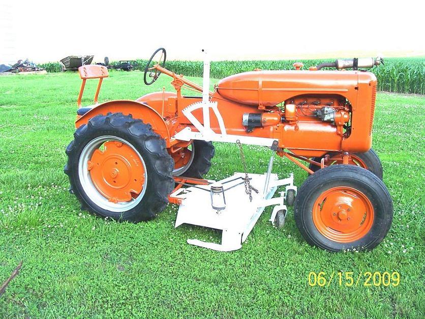

another option would be an Allis "B" Farm Tractor... about 2000 pounds and 20 HP..
I doubt you need a snow blower in Tenn... Maybe just a back blade ... and you can move a little dirt or driveway rockes with it also.. If the B was equipped with a 3 point hitch, you can use a small plow or disc... Finish mower or belly mower are available... Cost is probably cheaper than a large Garden Tractor.. and yes, they basically last forever.. As long as you are flexible enought to get on and off... and have the room to park it..
