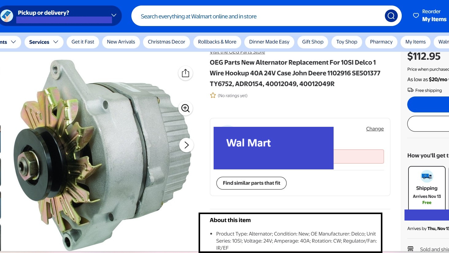

Post Options Post Options   Thanks (0) Thanks(0)   Quote steve(ill) Quote  Post ReplyReply Direct Link To This Post Posted: 06 Nov 2025 at 4:24pm
Something like this... you have to figure out the mount and pulley / adjustment is the biggest deal..... Make sure the SPEC says "IR"  Internal Regulator... Some dont..

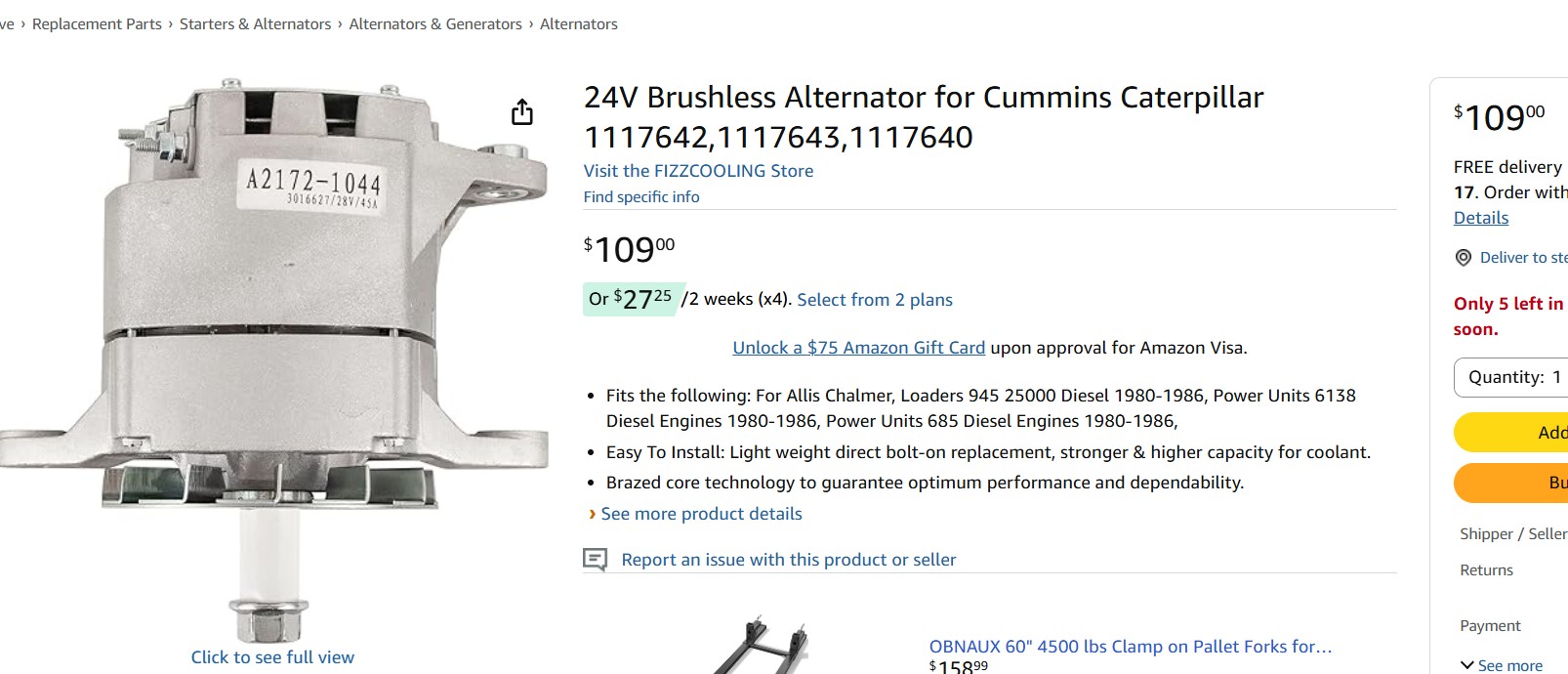

Post Options Post Options   Thanks (0) Thanks(0)   Quote Eric B Quote  Post ReplyReply Direct Link To This Post Posted: 06 Nov 2025 at 5:56pm
If the old generator has two 'mounting ears' at the bottom you may want to look over which make and model of a 24V Alt. would be the easier to adapt. There is one on Amazon that fits older A-C and Fiat-Allis machines, very reasonably priced as well. My picture posting skill failed me today or I would have put it on here Cry

Post Options Post Options   Thanks (0) Thanks(0)   Quote steve(ill) Quote  Post ReplyReply Direct Link To This Post Posted: 06 Nov 2025 at 7:58pm
Eric.... something like this ?  I agree the double mount makes things easier..
