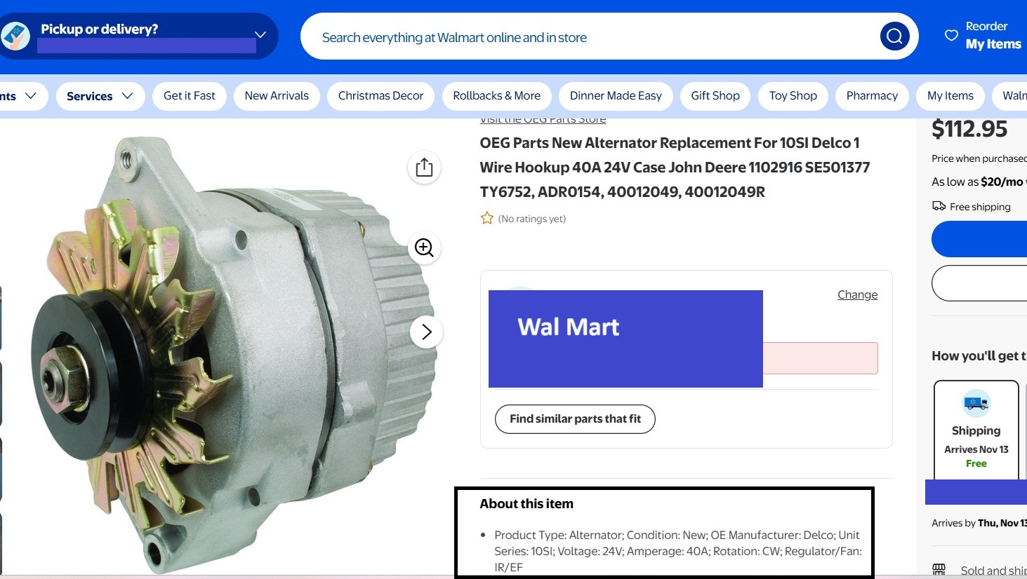

Post Options Post Options   Thanks (0) Thanks(0)   Quote steve(ill) Quote  Post ReplyReply Direct Link To This Post Posted: 2 hours 49 minutes ago at 4:24pm
Something like this... you have to figure out the mount and pulley / adjustment is the biggest deal..... Make sure the SPEC says "IR"  Internal Regulator... Some dont..
