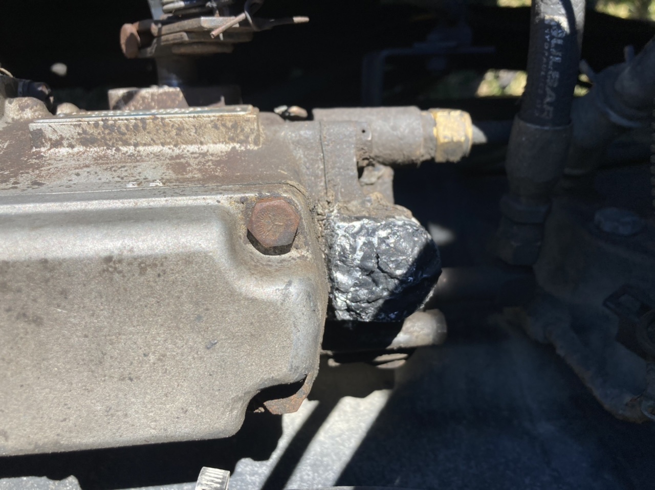

Hello, I purchased a 8070 off the internet LOL It's an '84 model and somebody along the way removed the entire manual primer off the injector pump and filled the hole with silicone.  This is a 45 degree fitting that threads into the pump on one end and the manual primer pump assembly threads on the other.  The parts book and the dealer both say this fitting is unavailable (part number 740630058, #5 on 8070 parts book page 74, 75).  Does anybody know where I might find one?  I've talked to a couple of pump rebuilders but they don't want to separate one from a pump which I understand.  I've been told that some Gleaner models used the same engine.  Would anyone know of a parts machine sitting around?  Thanks for the help.

Oh, I have issues alright.

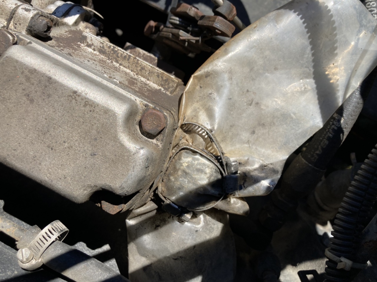

This is the previous owners fix. A piece of plastic clamped over the hole.
Under the plastic is a combination of aluminum foil and RTV silicone.

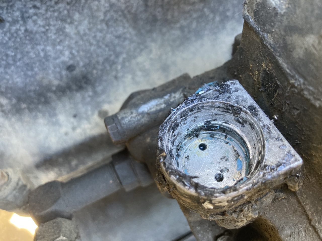

And as I suspected, under the silicone, not a single thread.
Does anybody have the rear case for this pump or should I just start over with a rebuilt?

When I rebuild those pumps, those really fine threads sometimes gall upon disassembly. I send the rear piece off and they put a new thread insert in. But, I only do that on a rebuild, I cannot sell pump parts separately. I'd imagine someone will have a good used one to sell you.

One last question for you.  The previous owner installed an electric fuel pump between the tank and the injector pump so I'm thinking this would really eliminate the need for the manual primer.  Rather than putting a thread insert in the case to screw in the primer, could I just tap the two small holes under the primer and put plugs in them?

It would work.

Is there anything directly under those ports that I need to be careful of?

Post Options Post Options   Thanks (0) Thanks(0)   Quote injpumpEd Quote  Post ReplyReply Direct Link To This Post Posted: 23 Feb 2022 at 12:55pm
2 check valves down inside. Definitely not the preferred method. Hard to keep the chips from getting in.

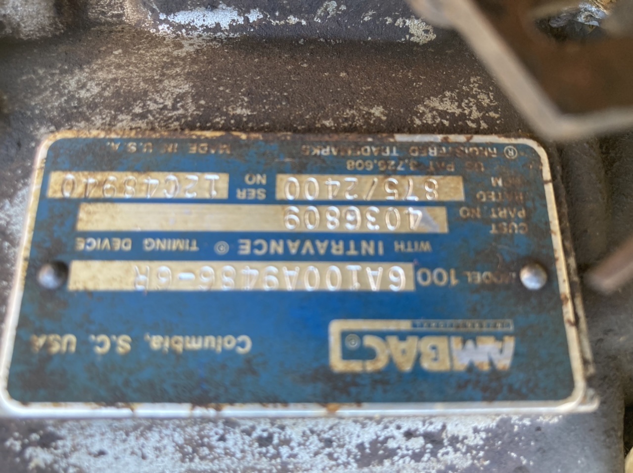

The pump on my 8070 is an Ambec 100. If you have parts, I’d be more than happy to pay you for them since other posters aren’t impressed with my fix
