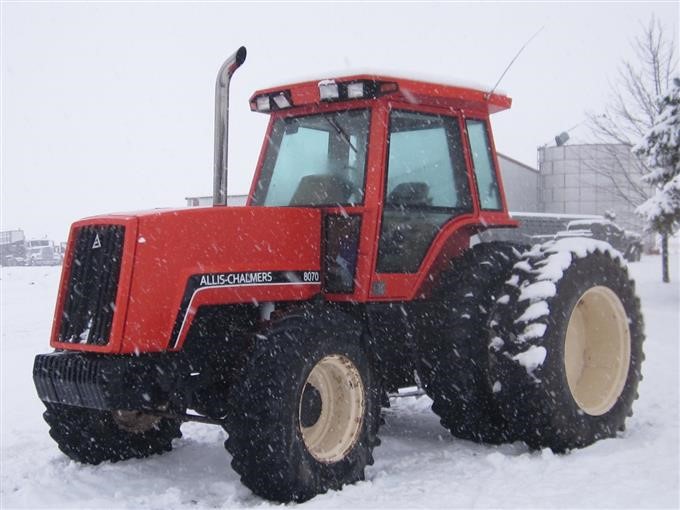

I have a 8070 and just noticed something.  I has 26" rims on the front and noticed in a prior post they show 24 and 28" as options not 26..  Not such a big deal if they are appropriate height for the Rear tires... But want to make sure they are.  Rears are 18.4R38 and the Fronts have 420/85/26.  If Im calculating that out correctly that makes I have 16.9R26's on the Front with 18.4R 38's on back.  Help me out!! uploads/14834/8070.jpg

Just bought so no... when i drove it around didnt notice anything funny either nor did i think the front tires were taller proportionally compared to the rears.  When i was looking through the fourms on here someone posted this so im a little nervous ... again this is on someone elses post
Front                                         Rear
13.6 x 28                                  18.4 x 38
14.9 x 28                                  20.8 x 38 or 18.4 x 42
14.9 x 24                                  16.9 x 38
Edited by Nebraskafarms - 03 Jan 2016 at 2:48pm

Again what i have is 16.9R26's on the Front with 18.4R 38's on back.......... so around 2.5 inches Taller then what im seeing in the prior post as recommendations with those rears what are your guys thoughts?  I didnt notice any pulling or anything when i test drove it or anything with the Front wheels on

Engineering tried to have 2-3% more travel speed (lead) with the fronts compared to the rear (gearing and tire sizes figured in).  This primarily was to help with turning.
According to the Firestone Tire Data Book    http://dawsontireservice.com/wp-content/uploads/2013/07/FirestoneAgTireDatabook.pdf    the 16.9-26 has a 4% larger loaded radius than the 13.6-28.  This would result in a 6-7% higher travel speed (lead).  This will wear out front tires faster and won't help the life of the FWA drivetrain components.
The clutch for the FWA will limit the torque to the front wheels, so you may not notice a problem on high traction surfaces.  However, the clutch won't be happy doing that  continuously either.

To make a long story short, Allis was wrong with putting the 18.4-26's on the front with 20.8-38's. They are to tall. Correct tire size with 18.4-38's are a 13.6-28, or a 14.9-26 if that size is even available. 20.8-38's would be 14.9-28 or 16.9-26. 20.8-42's would take a 16.9-28 or 18.4-26. We put 20.8-42's on our 8050 and I went over all the tire sizes with the tire dealer to find the correct height.

That would be my guess. Our 8050's front was wore out from the oversized tires too. Find yourself either a set of 13.6-28's or put some 20.8-38's on the rear.
