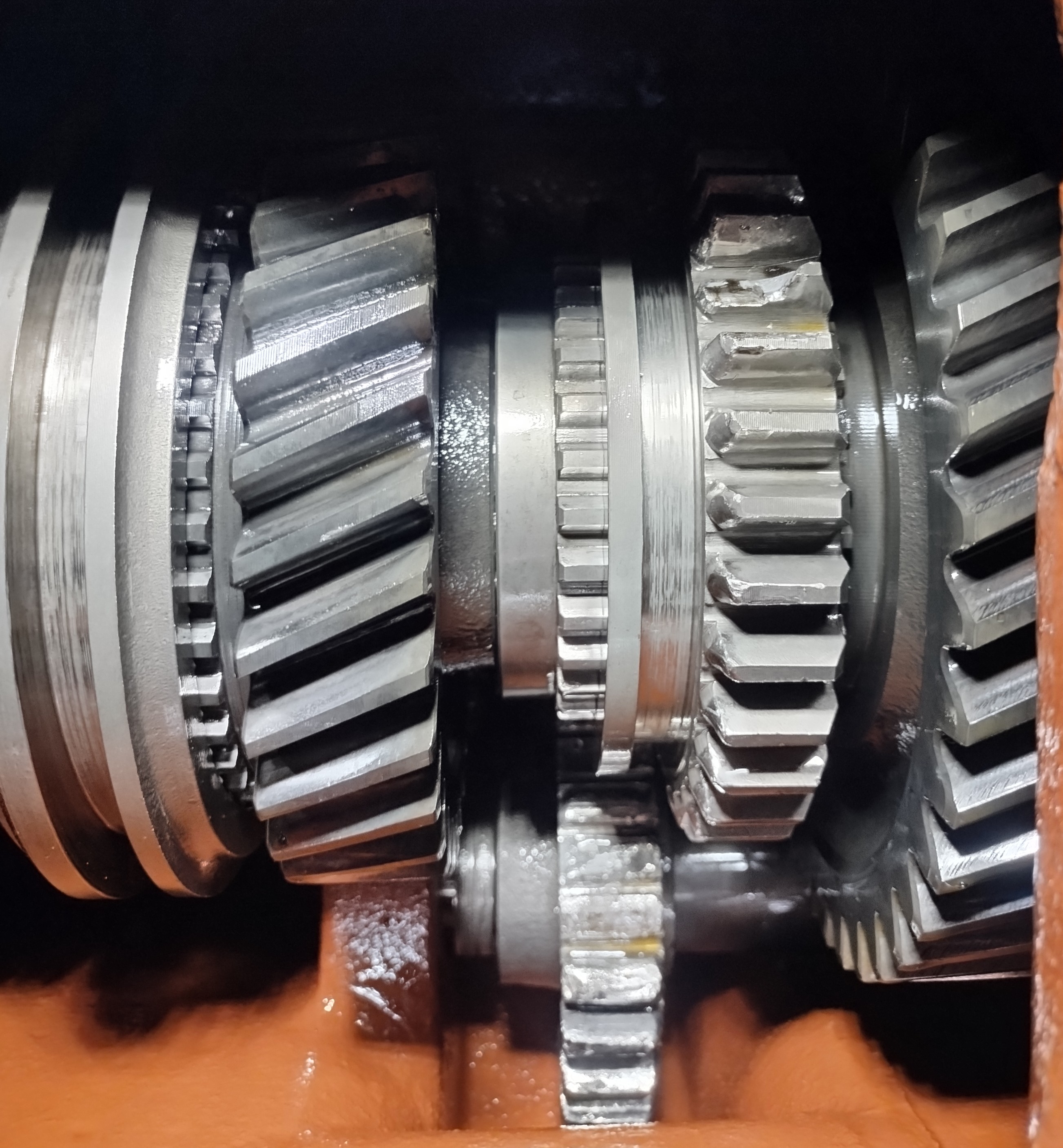

youngorange2000
Silver Level Joined: 27 Mar 2019 Location: eastcentral MN Points: 310 |
Post Options
Thanks(0)
Looks like all my reverse gears are toast.
Lynn Marshall
Orange Level Access Joined: 13 Sep 2009 Location: Dana, Iowa Points: 2257 |
Post Options
Thanks(0)
That's a big 10-4. You guys are rewriting the book on destroying machines that I thought were nearly indestructible. Ring gear busted on a 7045 and now reverse gear failure on an 8050. This is another very odd failure. Sorry for your bad luck and another pretty big job to tackle. Used parts shouldn't be a problem with such a rare problem.

Do they interchange?
youngorange2000
Post Options
Thanks(0)
Doing some digging on agco parts books. The gears do interchange between a 7060 and 8050 PD transmission
