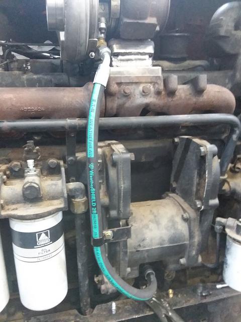

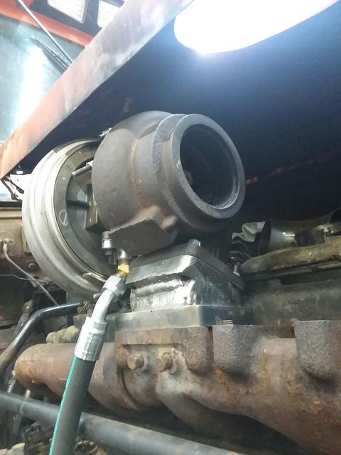

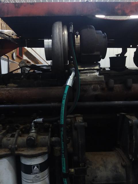

Sorry about no update in a while. Been busy with other stuff. I've decided to make a turbo wedge adapter to go from the T6 flange to a T4 and use a different turbo. The original was blowing oil out so instead of rebuild it, I figured I'll upgrade it. Using the wedge adapter allowed me to have the turbo pushed in far enough to clear the stock hood width. So I won't have to widen the hood at all. WOO-HOO! other side is a different story though. Will be working on that later. Got new oil drain and feed lines made for turbo and new longer oil cooler hoses too. More to come!
7095-685I at 255hp, 8070-225HP,8050-210Hp,8030 with 155HP,220 with 670T engine with A-pump, 7580, 185 with 140HP, 2-6080's,6070, S4 D17,wd45,CA,st34 agco, S1 D17 with 3500MK2

Nice job! If you wanted make another,, I'm wanting to fit a 3 lm turbo under the hood on a 190 Xt for pulling so I wouldn't need it till next June,,

Thanks! It was a pain... it's also a divided spacer too. Welding in the wedges and using the pencil grinder to smooth it all out on the inside was lots of fun!! Haha. So Idk about making another one though.... lol

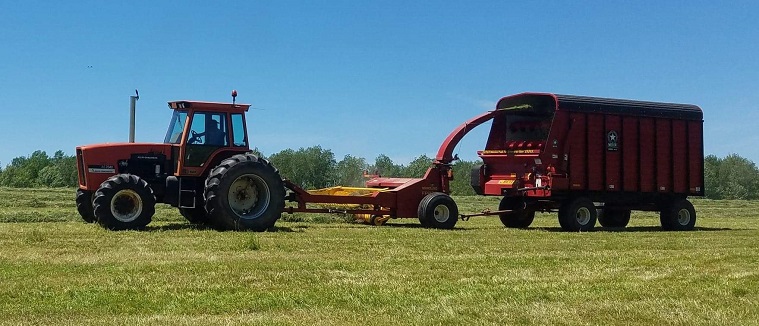

Hey guys, sorry I havent updated this thread on the 7095. Cant find a good easy photo hosting site so I've been uploading to our farm Facebook page. Here's the link, Peterson Farms Facebook Page
Had her on the dyno awhile ago and she is putting a easy 255Hp out. Have ran her on the chopper all first crop and now starting second, all I can say is WOW so much more "Oomph" than the 426. Dont have to really worry about slugs of hay going in to fast anymore, just powers right through them. Before with either the 8070 or 8050 one would have to quickly shut off the head before it sucked it all into the cutter head and bogged the engine way down.
Cant wait to get her all painted up this winter and maybe take her to a show or two! It sure is awesome!
