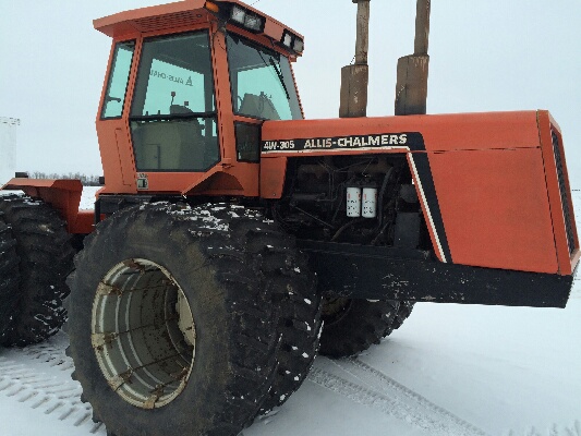

Ok guys, some of you may have read on my other thread about this 8050 I'm working on putting a 685I in it. Got the tractor in the shop today to start working on it. Will be having a rear engine plate made locally. I've gathered some parts and I think I got most of what I need. Tractor will be getting 6 inches added to the side frames, along with widening the hood out around that 5-6 inches. Will tell for sure when I have the engine sitting in the tractor.
Main purpose of this tractor will be running out forage chopper, and really nothing else. Have 3 other 8000s and the 7580 to do tillage work. The 8050 is a powershift tractor also. To remedy some clearance issues, it will be getting 7000 series front sheet metal, but with the 8000 series cab. Dont expect me to post pics everyday though, hopefully it drys out some here and we can get in the fields. But I'll post lots of pics when I do work on it. Thanks guys!
7095-685I at 255hp, 8070-225HP,8050-210Hp,8030 with 155HP,220 with 670T engine with A-pump, 7580, 185 with 140HP, 2-6080's,6070, S4 D17,wd45,CA,st34 agco, S1 D17 with 3500MK2

Patiently waiting for her new heart.
Waiting
9 blade poly fan I'll be using.
Fan
The "look" we will be going for.
prototype
