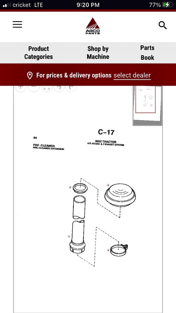

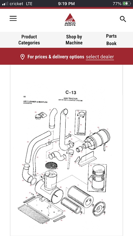

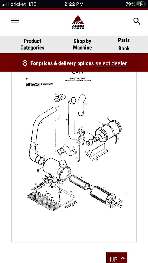

Before you pull air intake from turbo, go first to the 8050’s engine’s air filter canister & inspect for a bird’s nest built around outside of air filters??
Have had similar results if tractor has been dormant for months. Sparrows & black Starlings seem to love the Allis tractors engine air intakes before filter. They can enter thru pre-cleaner vents & pack their nesting/straw/twigs tight inside it.

hard to imagine a bird being able to get through the screen on the asperatoron an 8000
