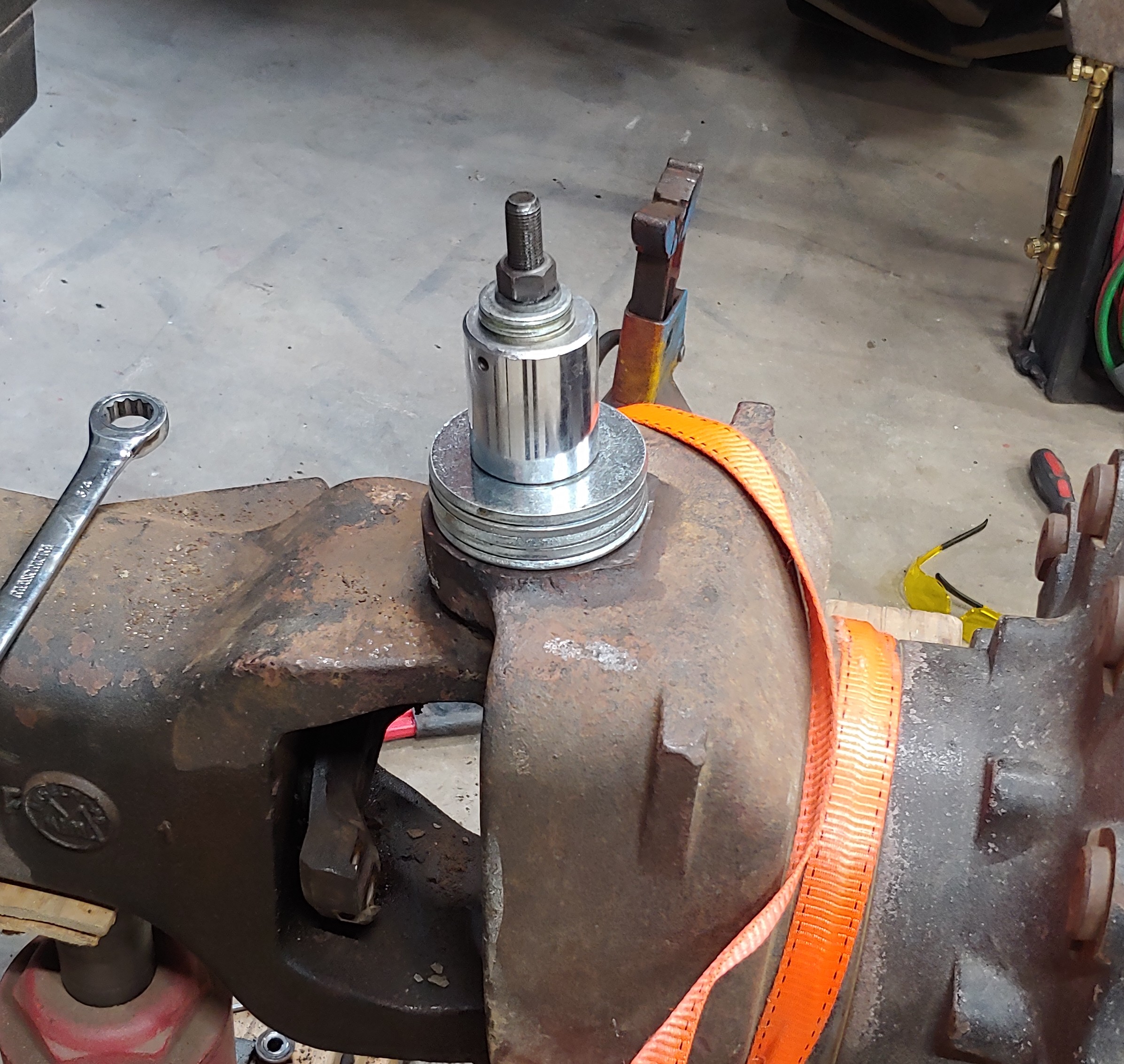

Before I start making a mess, is there a trick to pulling the king pins out of the knuckle?
Thanks!

There is a puller for those. Threads in the grease zerk and pulls the pin out.

Take the grease fitting out. Its metric. Determine the size and thread pitch
Get a threaded rod that size and cut a piecce long enough to go through a socket that is bigger than the pin so that it is against the knuckle. Good grade threaded rod is better. With a nut and washers on the rod screwed into the pin the socket gives you a hollw place to pull the pin out. May have to use a little heat on thee knuckle

I think there is another way...take out the grease nipple, then weld a nut over top (3/8- 1/2"), thread a rod into it, put a piece of pipe over it then a thick washer or two, then a nut, and tighten it and it pulls upward.
Grind off the welds when its out.

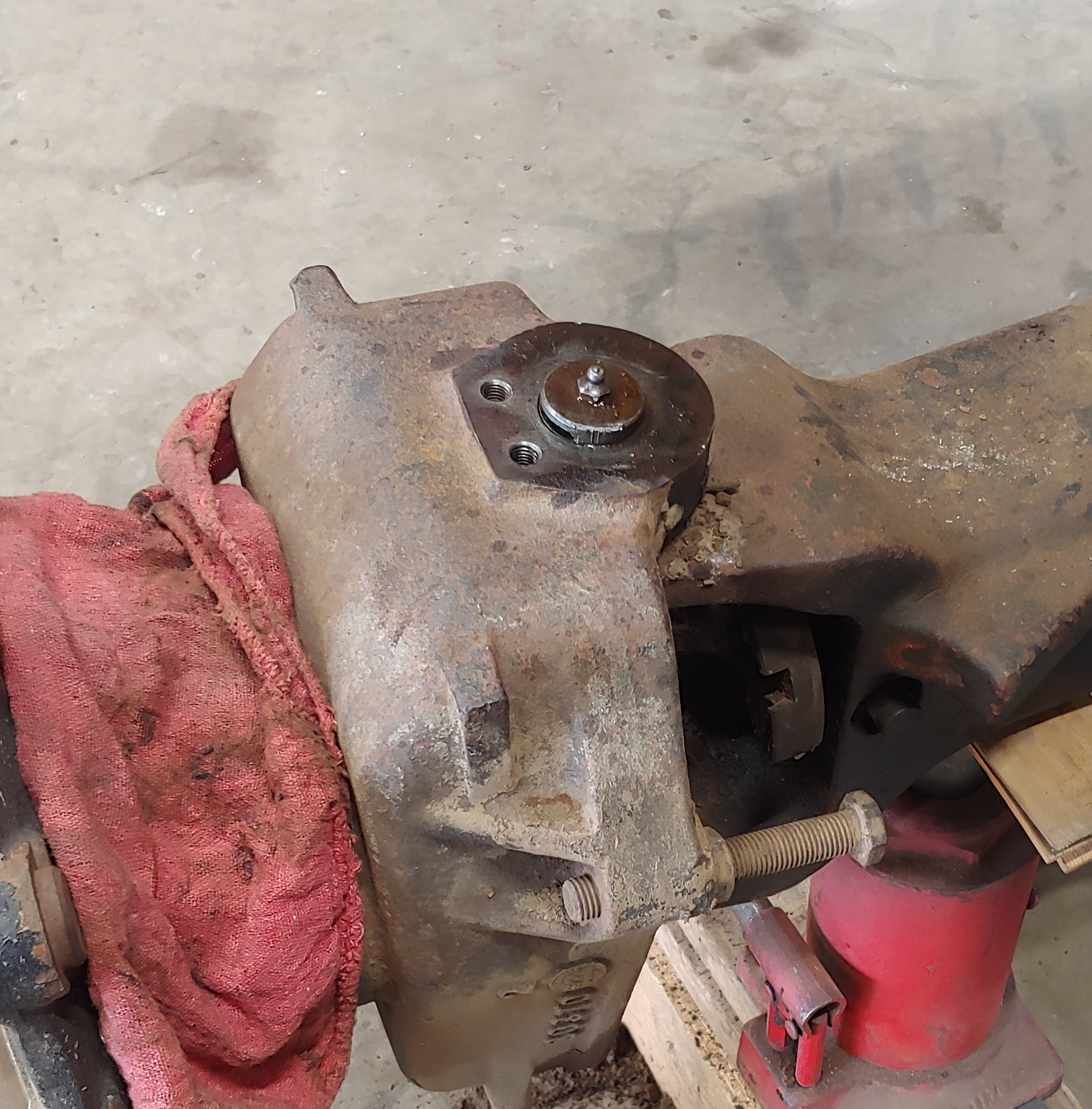

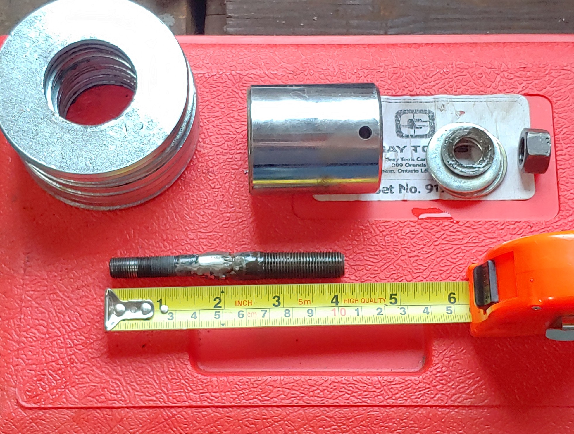

Pin internal threads for the puller are M10-1.0.. cut a bolt and welded a 1/2" fine thread to it. Worked good, kept stacking 1 1/2" washers under the socket as it came out. Pins actually in good shape. Bearing was screwed, cage half gone. Flushed the housing out can't see any metal anymore.
Will change the other side now that I'm all set up to do it
