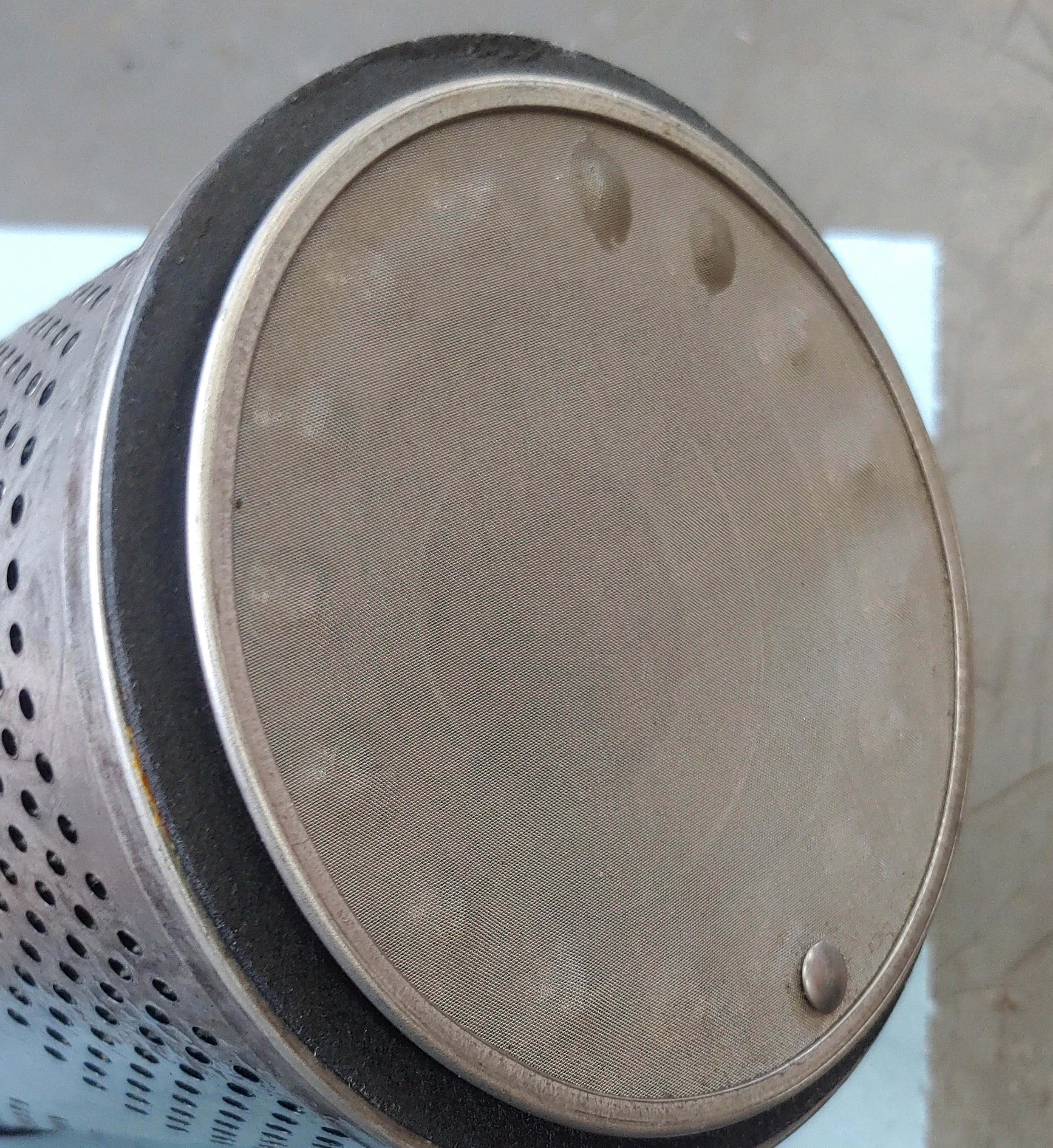

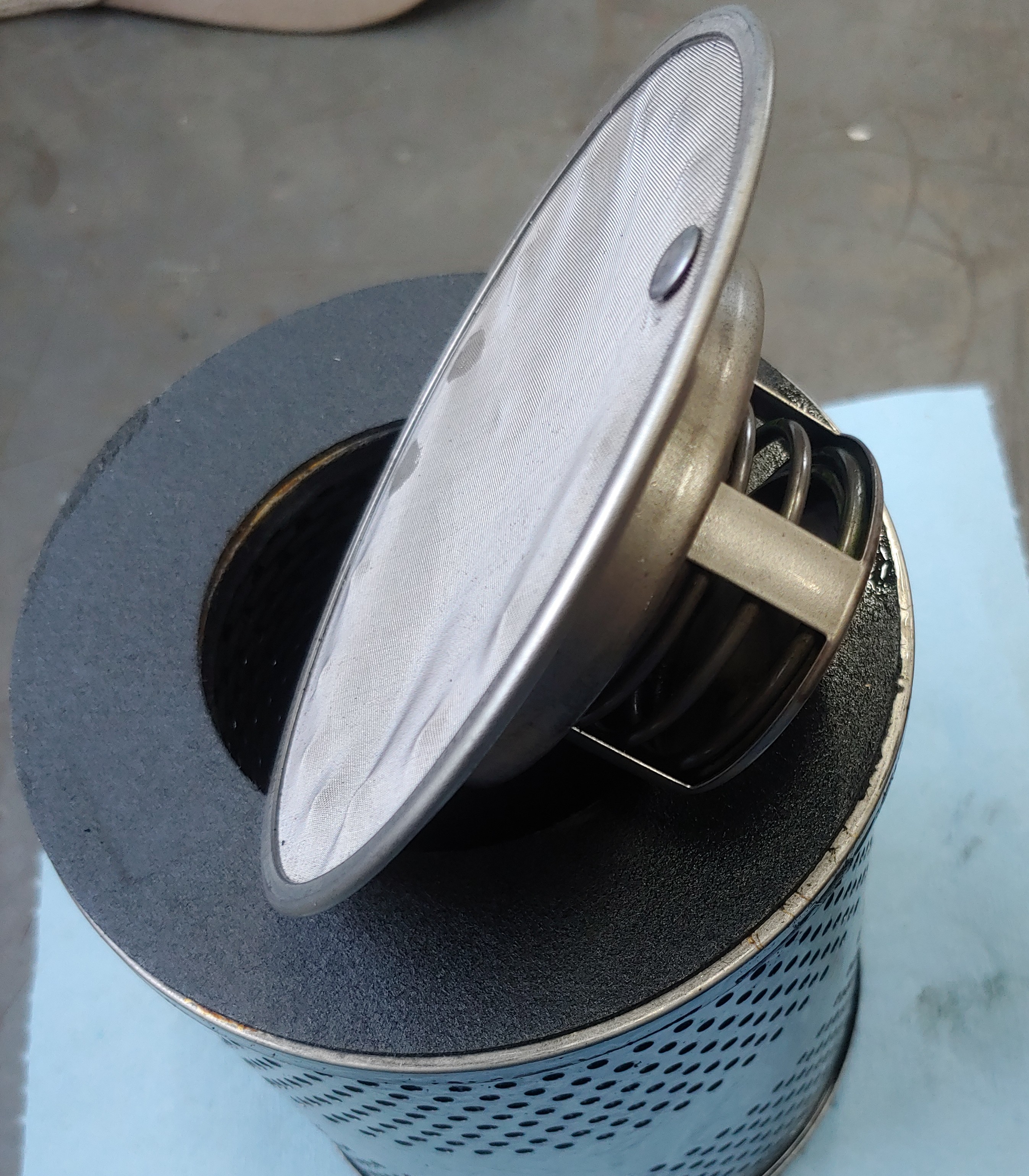

Hi all, pulled my left hand hydraulic filter just now and the inner bit the book calls the screen and valve assembly is missing completely (first time I've touched it)
There's an impression in the paper on the end of the filter matching the tabs for the anti drain valve so it looks like it sealed but definitely not right
Curious has anyone got one from AGCO or will I be phoning wreckers?
Matt

If its the part I'm thinking it looks like its backordered at the moment. About 70 bucks through AGCO.  70271742

Does the filter work at all with it missing? Seems like the fluid would flow straight through

No filtering at all. Straight thru to the power steering gear pump with whatever is in the oil.

For the benefit of future searches on the subject, part number 70271742 is the screen/bypass valve. Found one at a salvage yard off of a 7000 series powershift.
As the Doc says without it there is no filtering at all.
