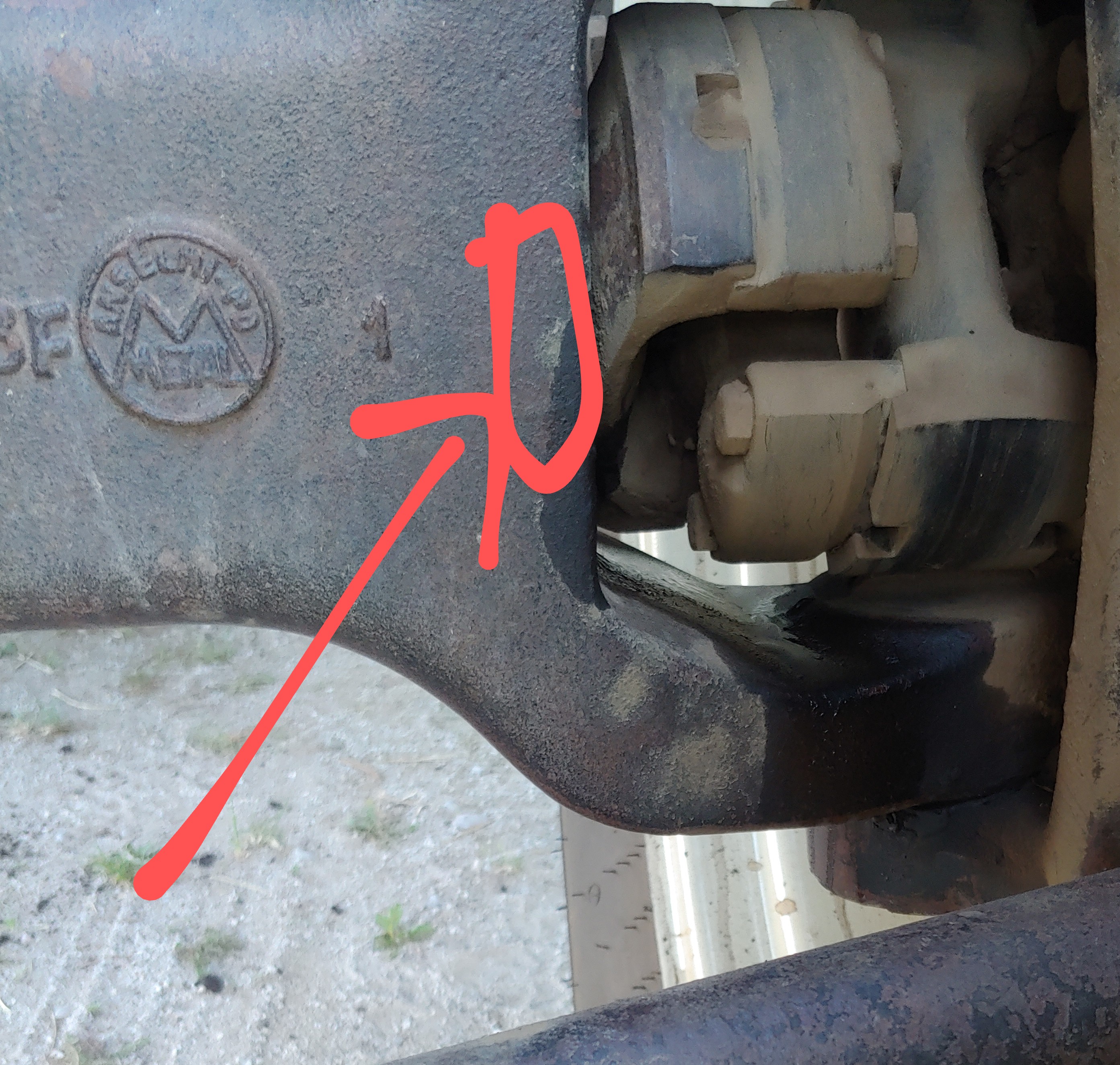

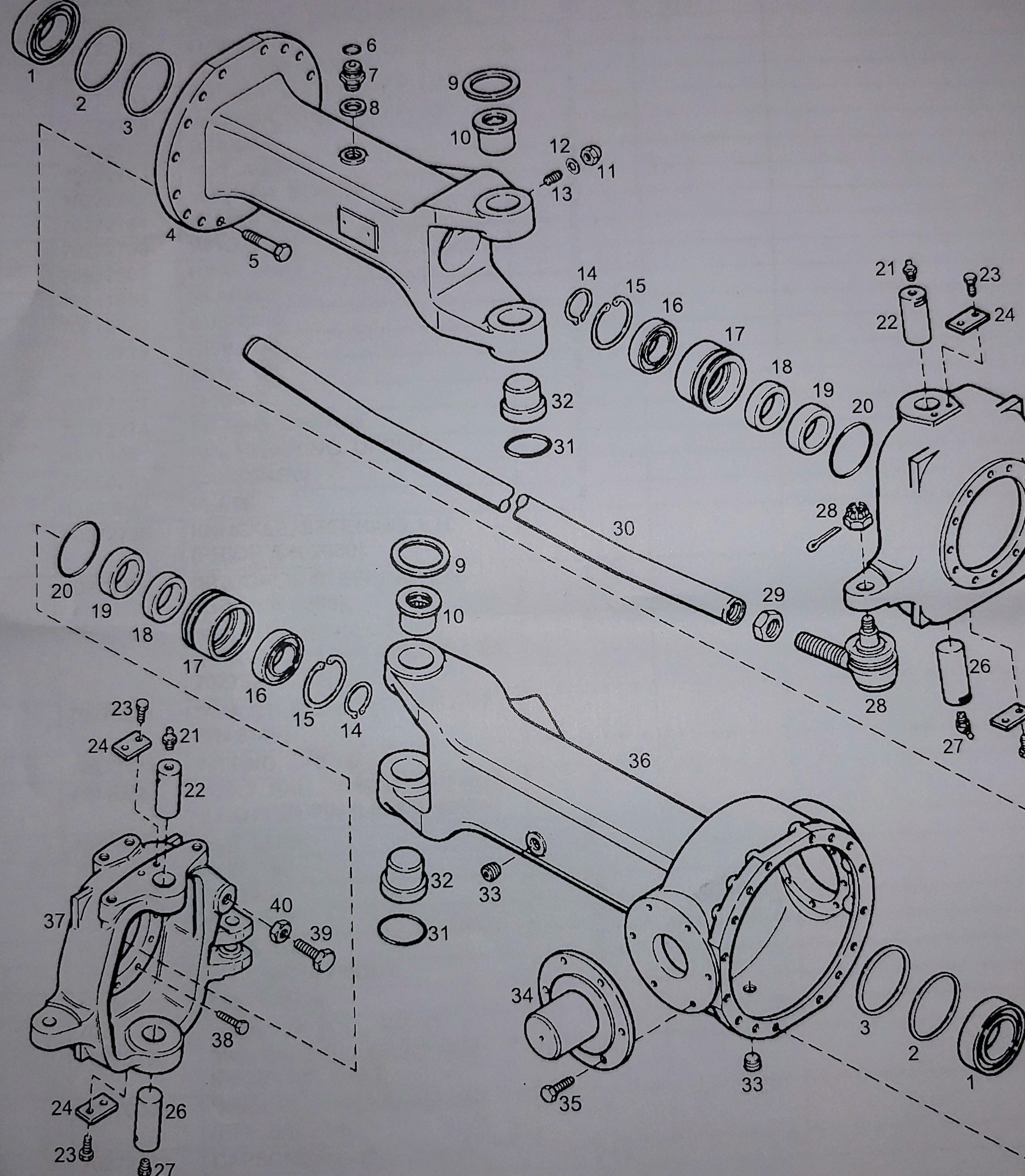

Hi all, axle stub leaking on the front as seen in the pic, axle has some movement so guessing bearing is on the way out ...which bearing and seal is it in the diagram?
I'd like to preorder the parts but scratching my head as to which ones they are
Thanks

16 is the bearing. 17 is the “housing”. 18-19 are seals and 20 is the o ring for the bearing housing

Awesome thanks, does that bearing housing come out with the axle? Looks like it's got a clip on the inside

It will if you remove the screw #13.

Are you sure your bearing is going out?     My 8050 axle was leaking someone suggested I clean the breather and I did it doesn’t puke anymore.
Northern Hoser View Drop Down
Joined: 19 Feb 2020
Location: Canada
Points: 125
Post Options Post Options   Thanks (0) Thanks(0)   Quote Northern Hoser Quote  Post ReplyReply Direct Link To This Post Posted: 03 Jun 2023 at 7:44am
Thanks for the replies, I'll look at the breather again, I put a new O-Ring on it last fall could be clogged up I suppose, thanks for the suggestion.
