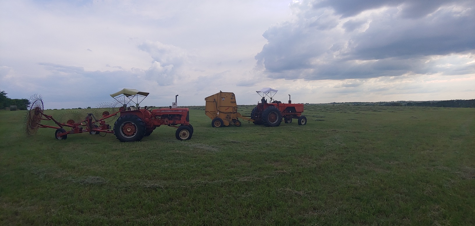

Baled hay last weekend with the 185. It was 98 degrees. I can't take that heat anymore. Trying to stay orange. Looking at 8010 with power director and an 8030 with power shift. I've never ran a PS before. Looks like the PD has more speeds.   Is there and advantage to the PS? I only do hay and shredding. The 8030 is 5k more with 1000 more hours. Both tractors have new paint and good tires.
Thanks Tim

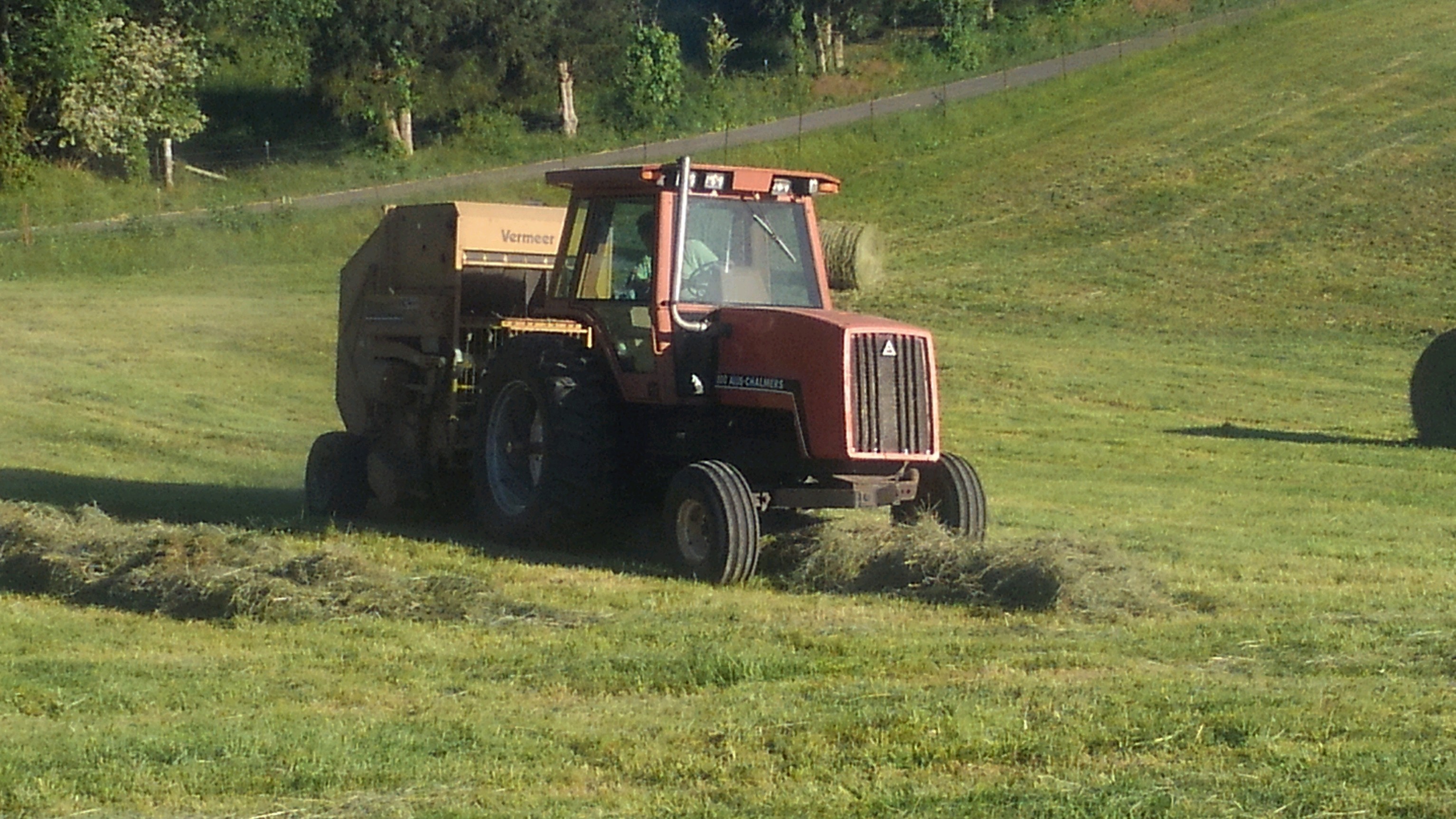

Post Options Post Options   Thanks (0) Thanks(0)   Quote Moneypit Quote  Post ReplyReply Direct Link To This Post Posted: 11 Jun 2020 at 11:11am
Yes just keep the rpms up. I use this he foot control a lot
