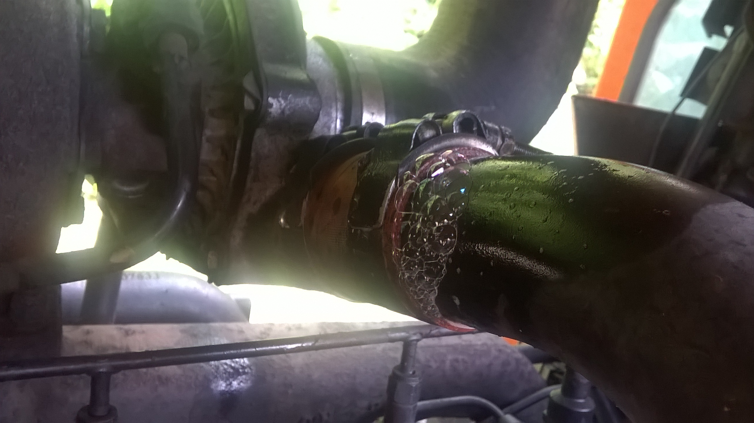

Run engine a high idle (wot) trans in park. Spray soapy water on all joints/questionable spots that could leak boost.
exSW View Drop Down
Joined: 21 Jul 2017
Location: Pennsylvania
Points: 914
Post Options Post Options   Thanks (0) Thanks(0)   Quote exSW Quote  Post ReplyReply Direct Link To This Post Posted: 28 Jul 2019 at 8:48am
Well that was easy

I'm thinking you have a big leak. That may just be a small leak. Seal it up and try it again on boost test.
I thought it was a little light too. No leaks around the crossover base or manifold. Figure if I fix that one it will put more pressure downstream.
exSW View Drop Down
Joined: 21 Jul 2017
Points: 914
Post Options Post Options   Thanks (0) Thanks(0)   Quote exSW Quote  Post ReplyReply Direct Link To This Post Posted: 28 Jul 2019 at 10:41am
All around the flange. So is it resealable?

Replace the turbo. A rebuild kit is bearings and seals. Yours is so eroded, you'd waste so much time trying to get it apart. Looks like that would likely take care of your issue.
