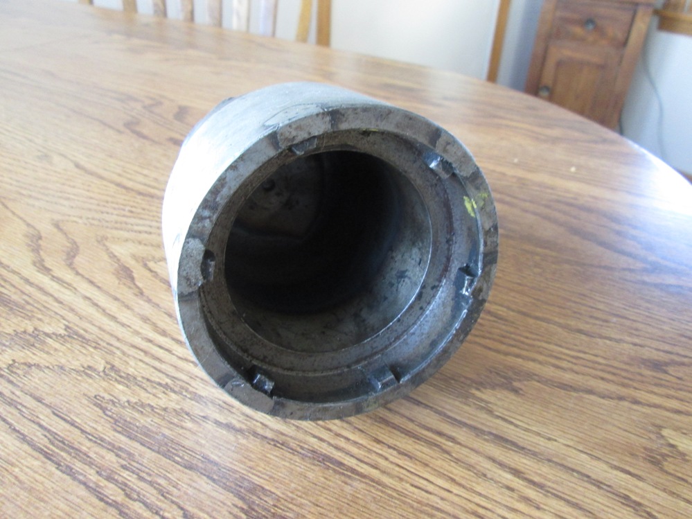

Lynn Marshall View Drop Down
Location: Dana, Iowa
Points: 2446
Post Options Post Options   Thanks (0) Thanks(0)   Quote Lynn Marshall Quote  Post ReplyReply Direct Link To This Post Posted: 05 Feb 2017 at 10:11am
I had this tool made. It's well built.
lentsch View Drop Down
Joined: 10 Feb 2011
Location: Glencoe,Mn.
Points: 236
Post Options Post Options   Thanks (0) Thanks(0)   Quote lentsch Quote  Post ReplyReply Direct Link To This Post Posted: 05 Feb 2017 at 11:07am
Lynn- that looks like it would be heavy duty! Do you know where that hole in the hollow shaft has to be positioned? I forgot to mark that when I took the 12 bolts out.
Points: 2446
Post Options Post Options   Thanks (0) Thanks(0)   Quote Lynn Marshall Quote  Post ReplyReply Direct Link To This Post Posted: 05 Feb 2017 at 12:38pm
I see no mention of positioning the oil hole in the service manual. If it was mine, I would probably put it at a 3 o'clock or 9 o'clock location rather than just straight up or down.
Joined: 10 Feb 2011
Points: 236
Post Options Post Options   Thanks (0) Thanks(0)   Quote lentsch Quote  Post ReplyReply Direct Link To This Post Posted: 06 Feb 2017 at 6:07pm
Thanks, after closer examination it looks like it was probably about 9 or 10 o'clock. Will your socket work with the shaft poking through? Mine will only work with the shaft removed. May have to do a little remodeling to make it work better!

Points: 8391
Post Options Post Options   Thanks (0) Thanks(0)   Quote DougG Quote  Post ReplyReply Direct Link To This Post Posted: 06 Feb 2017 at 7:21pm
Almost looks like a socket for  hub nut for a 4 whl drive truck,,,,
Joined: 10 Feb 2011
Points: 236
Post Options Post Options   Thanks (0) Thanks(0)   Quote lentsch Quote  Post ReplyReply Direct Link To This Post Posted: 06 Feb 2017 at 8:22pm
The OTC #1931 is for a 1997 to ??? Chev pickup I believe. Sorry no picture yet.
