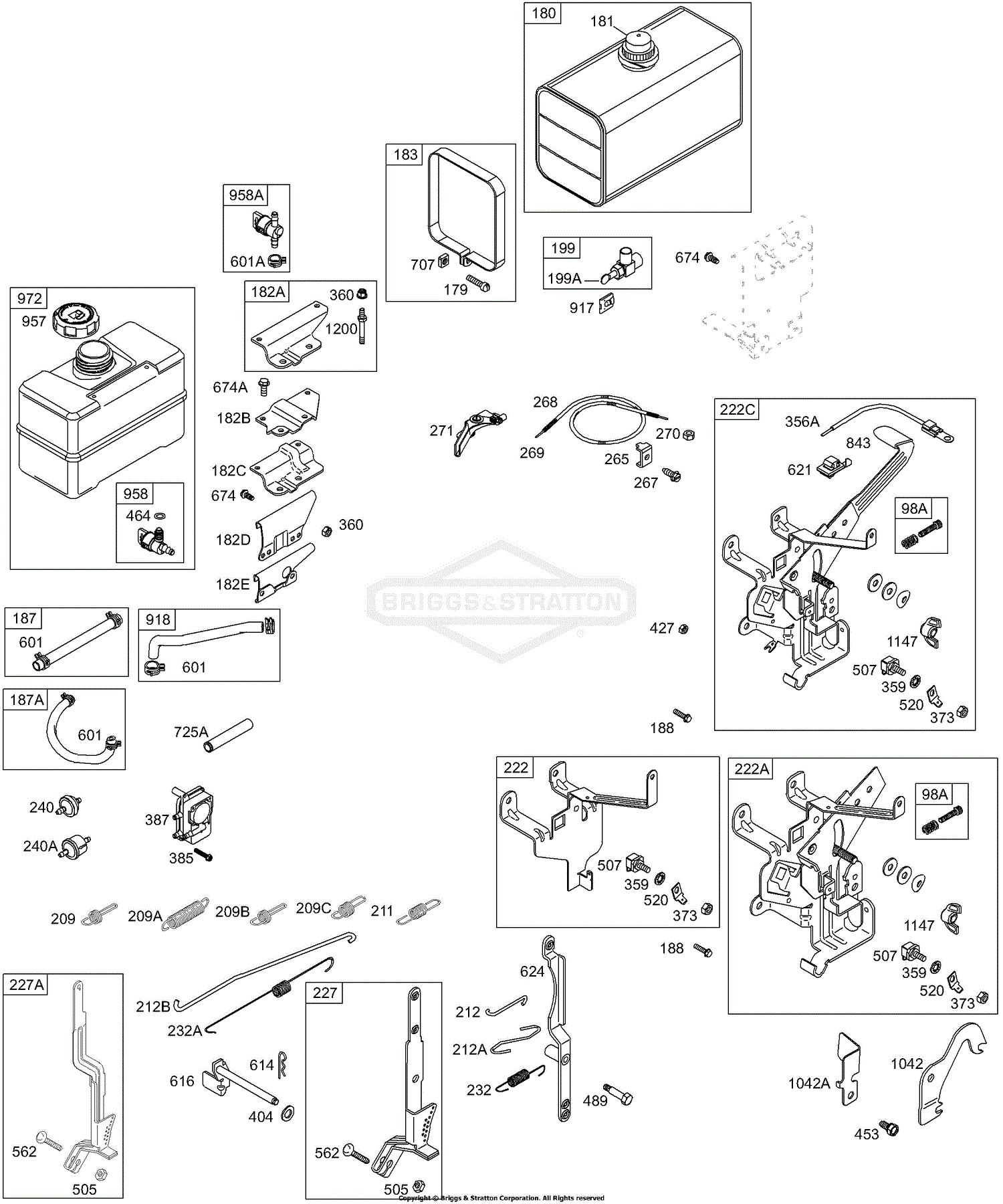

jay, it is a model 196432 type 1065-e code 0003081a HTH Tracy
Points: 25256
Post Options Post Options   Thanks (0) Thanks(0)   Quote jaybmiller Quote  Post ReplyReply Direct Link To This Post Posted: 01 Jul 2025 at 1:33pm
you should have a srping #232A, rod212 is the carb-guv 'control'
I googled"B&S 8HP 196432 type 1065-e" went to jacks small engines for diagram.
hopefully it helps ?
