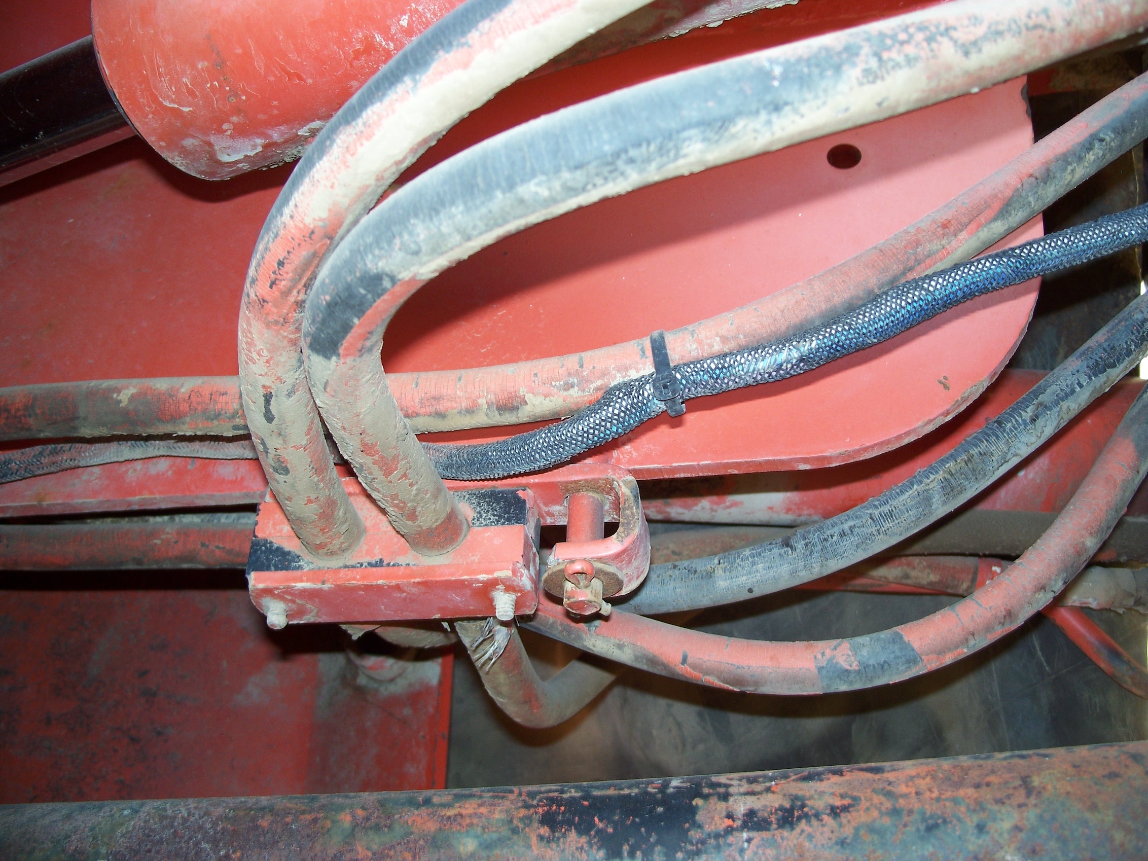

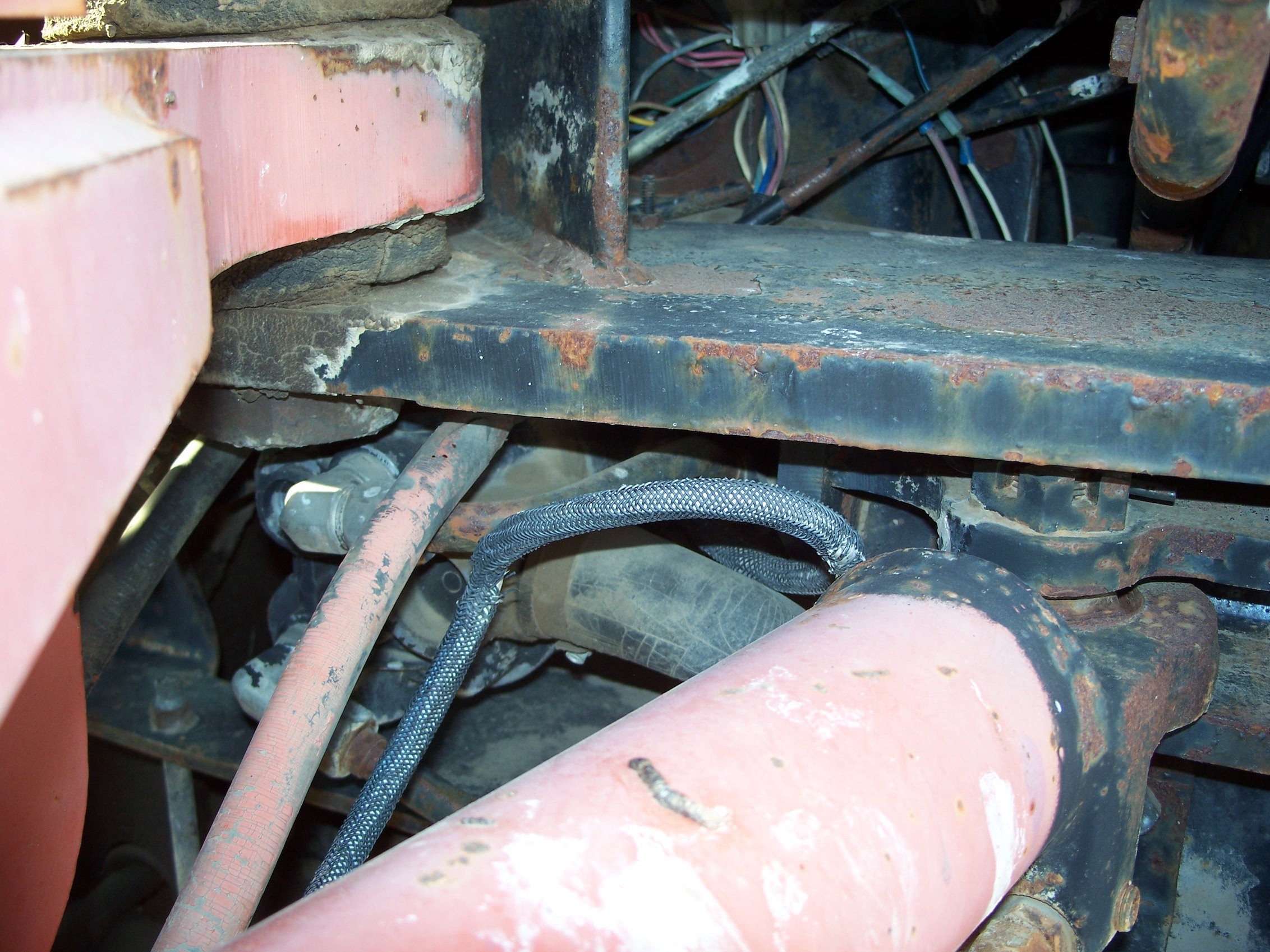

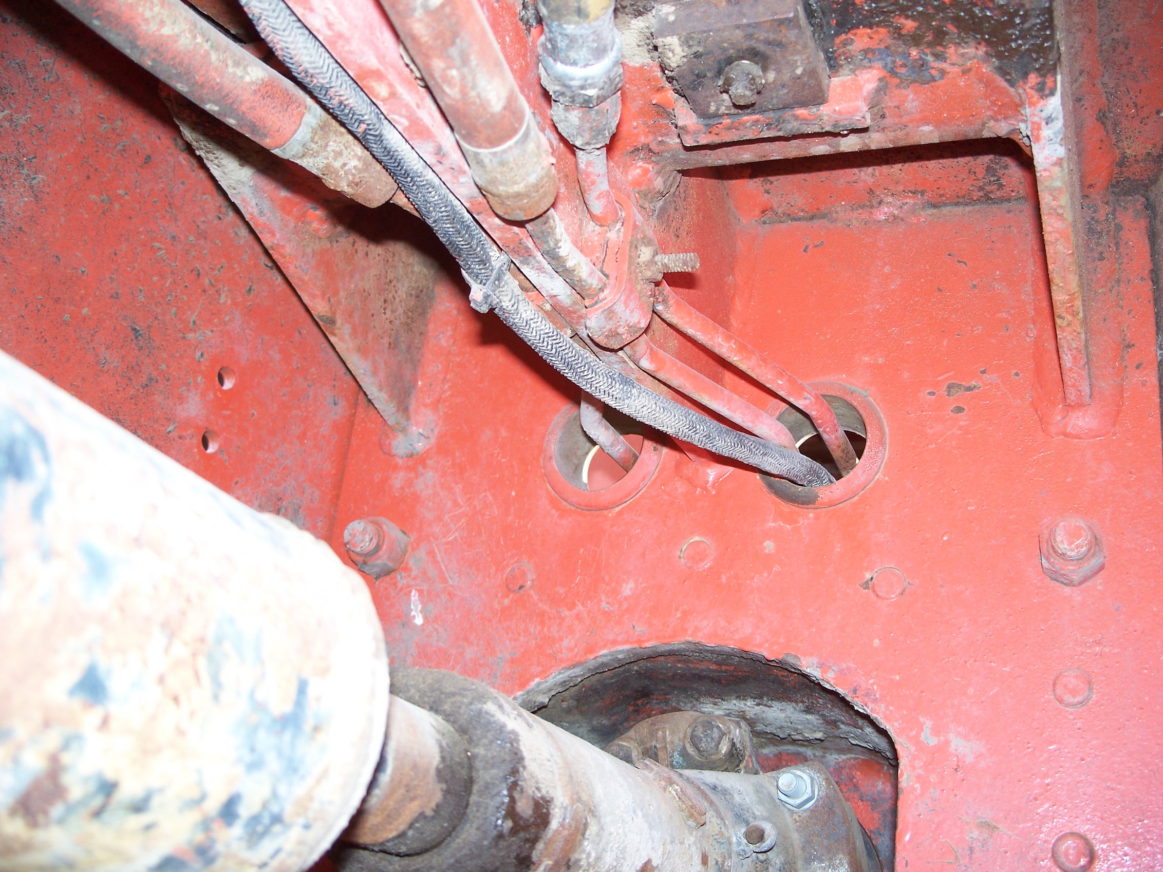

Post Options Post Options   Thanks (0) Thanks(0)   Quote LB0442 Quote  Post ReplyReply Direct Link To This Post Posted: 03 Sep 2019 at 8:32pm
Took a couple pictures of mine.  Runs right by the right steering cylinder.  Probably missing a wire tie there.
