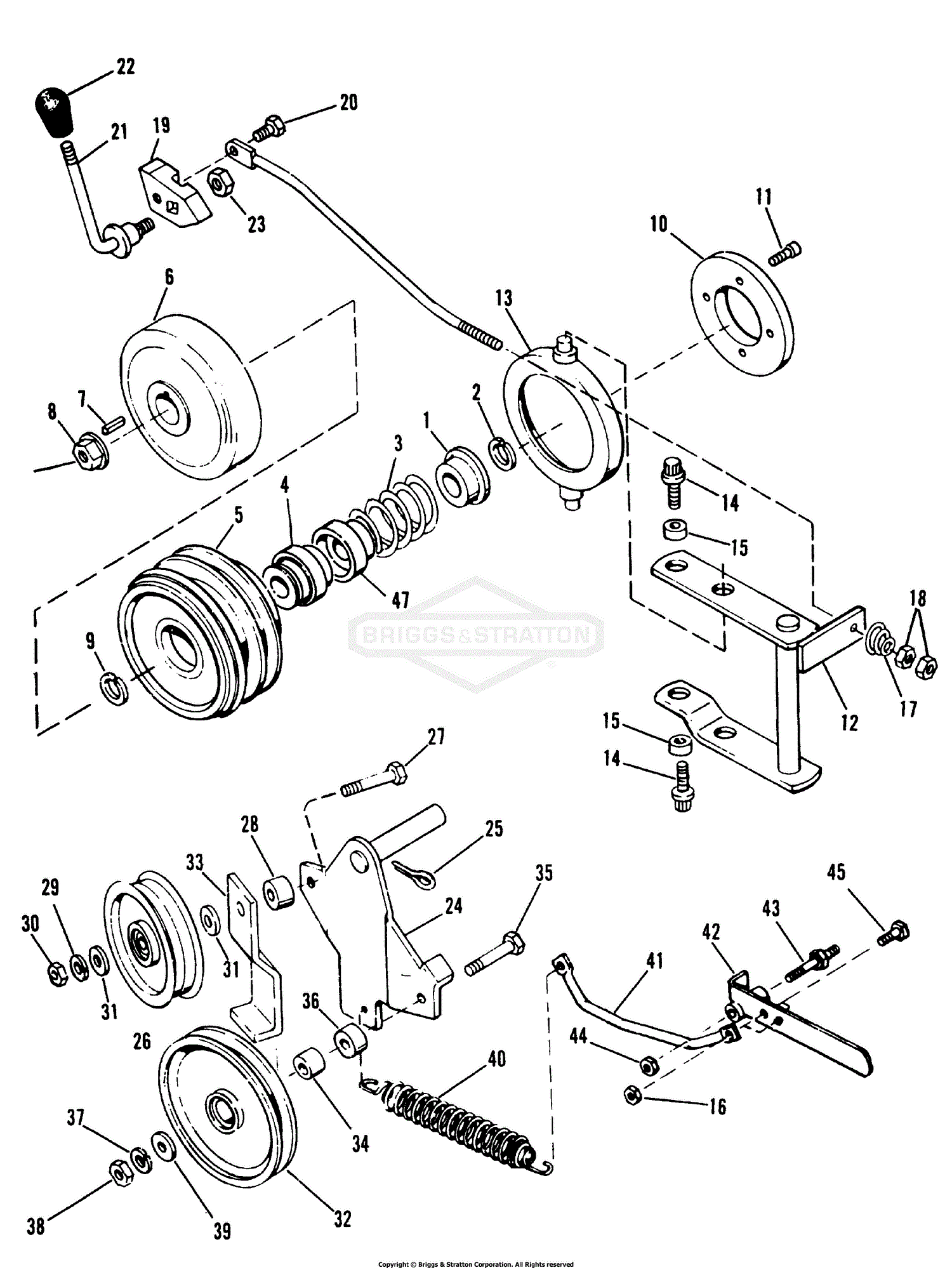

I looked on Jacks small engines and a parts view is on there showing the exploded view of the parts. --- It looks like the same setup that my 917 has on it. ---- your clutch plates are stuck together. The unit sits out in the open under the platform and gets dirt/water/snow in it and rusts together. They  are not on the engine on  these models. All power drive units use the same clutch on them. snowblower belt goes to front, tiller belt goes to the rear jackshaft.

This is the pto on these. The number 6 in pic. is the problem child for sticking shut.
716 and 917's have same set-up. Clutch is manual, over center type. not electric.

Sonny your right but the early 700s did have a front clutch for snow throwers. Have to wait and see what he says on what he has. We have a 710 and 716 with the front clutch. Then they went to using the long belt back to what your referring to. I'll see if I can get a picture of the front clutch for you.

o.k. Mike! This was the only thing they showed for the 716!-- I wasn't aware of different set-ups. Sorry.
