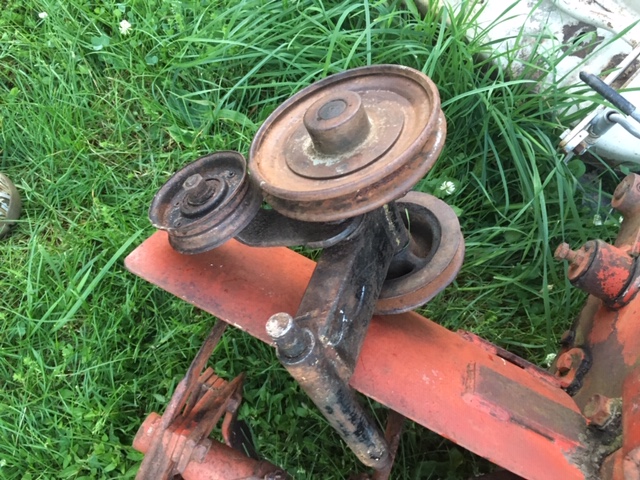

Finally figured out how to upload, as you can see my tiller is very different than that of the one on the video. More simple maybe?

That's a roto tiller off like a yellow early B 10 B 1 garden tractor. And the pulleys look like the mower pulleys from under the yellow tractors. I think

You have a tiller for the early tractors.  It can be made to work with your 710, but wasn't intended to.  There is a PTO/mule setup you will need, that is unique to that tiller design.
The mule you have shown is a mid PTO assembly for a B series tractor.  It is unrelated to any rear attachments.
A sleeve hitch is not needed for a tiller.  I am assuming you may mean you need the rear lift assembly?  A sleeve hitch works WITH a rear lift, for mounting sleeve hitch attachments like a moldboard plow, cultivators, planter etc.
