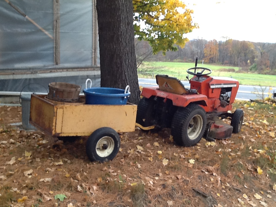

Yea the clutch in the middle goes down to the deck, and you can also run belt under seat to back and run anything back there like tiller leaf vacuum and other stuff. The 900s ran the blower down under like the deck just all the way up to the front.
That's awesome you got it running already.
Here's a picture of our two 710
