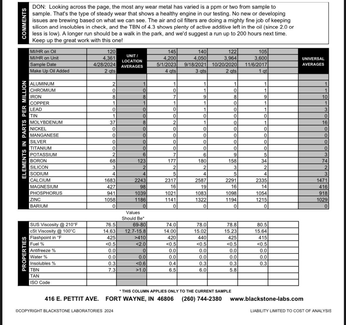

Have an 81’ 7080, good shape, 4500 original hours.   Never been apart. Starting to think about rod bearings and main bearings. Pull oil samples every year, saying no metals in sample yet. I assume we should pull oil pan as a first step to check? I have little motor experience, anyone have a step by step guide? Is the Shop manual a good reference for rod bearings? Still our main workhorse gets about 120 hours per year.

If the oil samples are fine, WHY would you want to open it up to do anything ??? The oil sampling is looking at things inside without doing so.

Everyone says 4500-5000 hours max on 7080 rod bearings? Quite a few posts on here saying that.
Looking for opinions, I’d rather not open it up. Just wait for oil sample to show some wear?

If you use the same oil analysis service, they are like your Doctor. They will tell you when something looks questionable. Main and rod bearing life is dependent on how many gallons per hour the engine uses (load), how frequent the oil and filters are changed and the quality of the oil and lastly clean air to breathe. If you've ever been around a poor old N-6 Gleaner with worn out helical bars and the boost gauge always at 20 psi for hrs on end, the rod bearings wear out much faster.

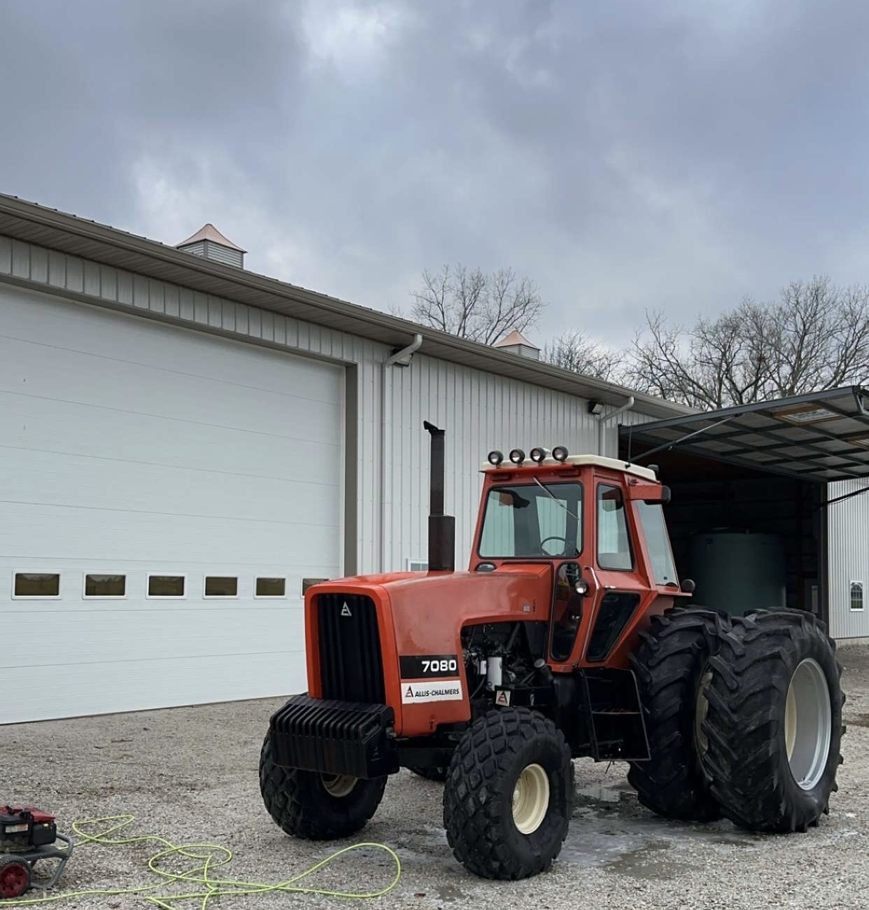

That’s a nice looking tractor you have

Thanks Dr, we are very religious on all filter and oil changes. 100-150 hours max. Annual oil samples and it’s always had A/C or Agco filters and Rotella 15w-40. Will keep an eye on samples for changes.

No advice on the bearings but that is about as sharp of a 7080 as I've ever seen.

I would imagine that tractor still has the 4-ring pistons and piston cooling is thru the main bearings. Only the very last few months of 1981 did any 7000 series engine get the newer pistons and piston cooling design.   When "brass" starts rising in the oil samples, that would indicate rod/main bearings are getting thin.
