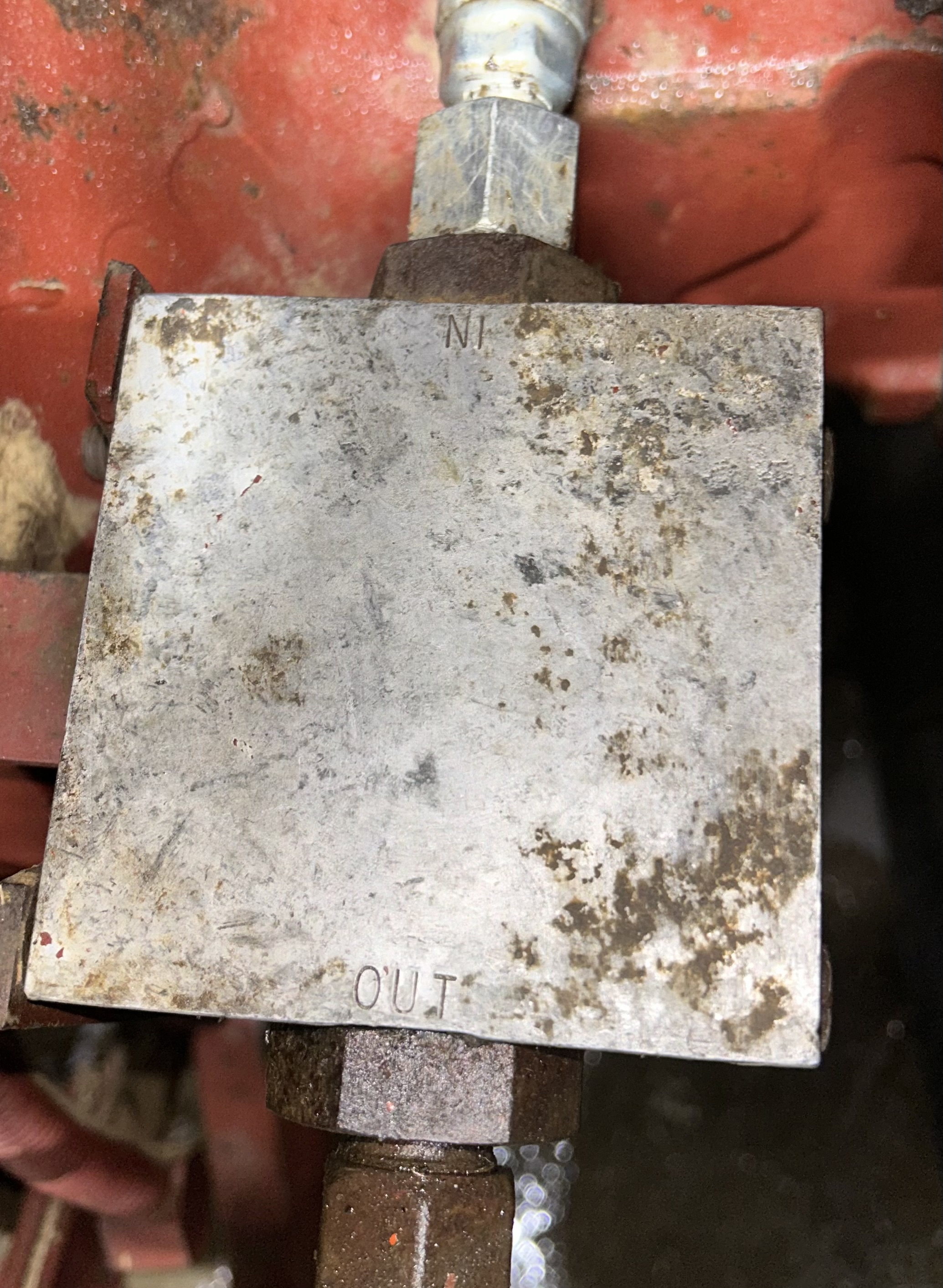

Back with another question and probably one of the dumbest things I’ve done in a while on my maroon belly 7060 powershift. While attempting to change the powershift filter something I do every winter I could not get the cartridge case to spin off, old small filter with no nut at the bottom even with a chain style vice grip filter wrench so I removed the entire filter head and got it to break free in the vice, now like a dummy I did not take note on the direction of the filter head and it is stamped IN and OUT and the lines appear to be the same size on both ends and it looks possible to get it backwards, my question is which line goes to OUT and which goes to IN? Picture is after I got it back together and then got to wondering if I got it positioned correctly.

Looks like you have it right. My early small filter 7060 shows the inlet side closest to the tractor so the flow is away from it
