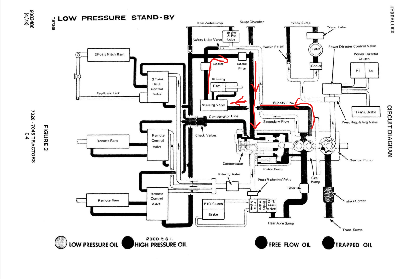

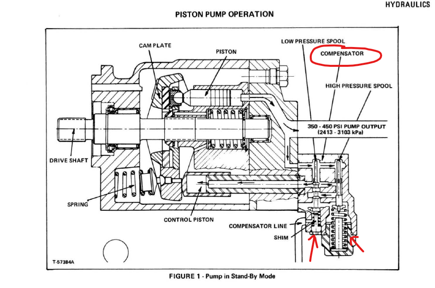

Take a look at this note and picture from the Allis manual. Note my sketches in red, which show how the T-Bar and end-cap can get bent over time (especially if the trap door hasn't been opening far enough and it's created a lot of suction pressure).
Edited by DanielW - 22 Jan 2026 at 8:00am

There are two compensator spools and springs. Either can cause issues if stuck or broken springs. If they are OK, I might think a broken swash plate spring inside the piston pump. But, if the power steering isn't up to par (cavitation or gear pump failure) it has an effect on the piston pump !! because it charges the piston pump. That's why I keep harping on the power steerings performance.

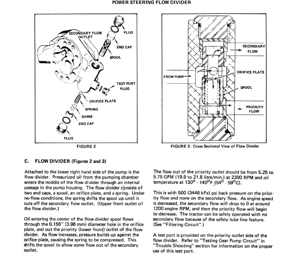

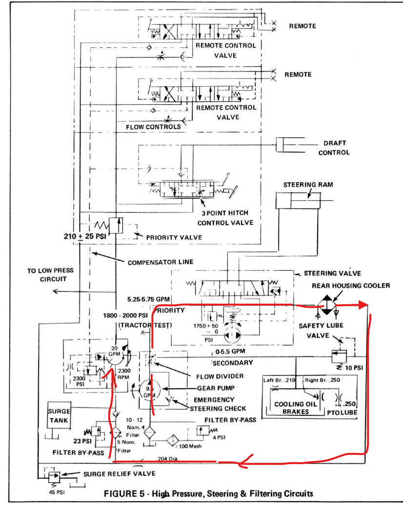

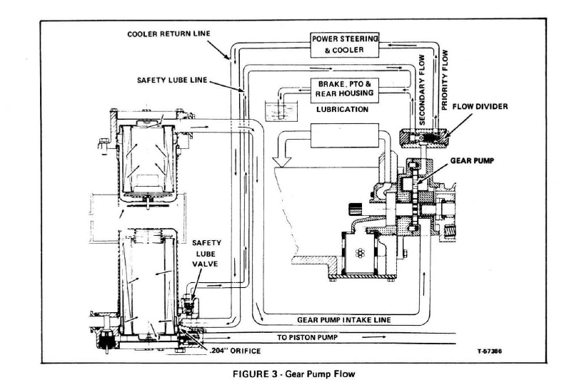

Take a look through these pictures below (sorry for the large size - working off my phone on break here and didn't have the time to re-size). Sounds an awful lot like inlet restriction to the either just the piston pump or gear pump - either with trap door or filter problems. Though a problematic priority/divider valve also sounds like a possible culprit.
You said in your earlier post that the steering was 'working, but isn't right'. Is the steering working correctly now? Or still problematic? More thorough tests are probably in order. But as a quick/dirty start of where to start looking: If the steering seems dandy but the three point and remotes seem awry, I'd be checking out the R.H. filter area again. If the steering also seems wonky, I'd be checking the priority valve spool to make sure it shifts freely, and also re-looking at the trap-door/LH filter.
No matter what, I'd probably still be pulling out the priority spool and making sure it shifts smoothy & easily in its bore. And I'd take the extra shim you added out of the compensator unless you've checked/set relief pressure as well. The compensator affects only the outlet pressure of the piston pump  - the pressure it de-strokes at. Which doesn't really sound like your problem. Again, I'm jumping to some conclusions here and this isn't guaranteed. But it sounds like when the piston pump is getting oil, it's working ok, and thus the compensator de-stroke pressure and relief settings were ok. Sounds more to me like the piston pump isn't getting sufficient oil. I wouldn't be adjusting/shimming compensator de-stroke pressure without ensuring I know what the difference between de-stroke and relief pressure is: This is something to keep in mind on any variable-displacement/closed-centre pump: You always need to have the relief pressure set a little higher than the compensator/de-stroke pressure (usually about 200-300 psi higher, depending on the system). Otherwise you'll just be blowing over the relief and creating lots of heat & excess pumping before it destrokes. Shimming the compensator to increase de-stroke pressure without also adjusting (or at least checking) the relief pressure is a big no-no.
Edited by DanielW - 05 Mar 2026 at 7:41am

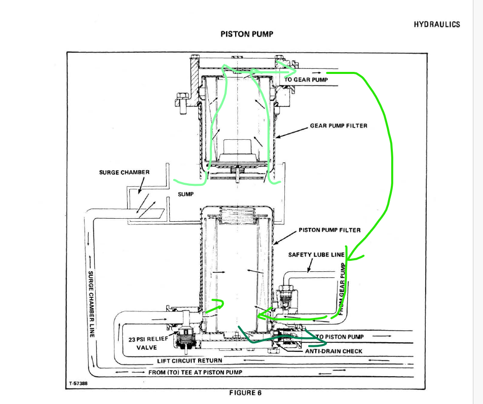

Further to my last reply: I never really answered your question of where the piston pump gets its oil from. This is a little over-simplified and I'm sure Dr. Allis will correct me, but the simple version is this:
The piston pump gets oil from the gear pump. The gear pump gets oil from the LH filter, sends it through the priority valve. Priority flow goes through the steering, then through the cooler, then to the RH filter. From the RH filter it goes to the piston pump.
There's also the surge chamber in the rear axle. This is a little chamber with a wall between it and the rest of the rear-end sump. There's a gap in the wall a couple inches from the bottom of the rear axle sump. When running in normal operation, the flow from the gear pump goes to both the piston pump and the surge chamber (the piston pump takes what it needs, and everything else goes to the surge chamber). This is because when you're humming along normally the gear pump delivers far more flow than the piston pump needs. When the surge chamber gets full, it spills over the gap in the wall back into the rest of the rear axle sump.
But the piston pump can, at times, require more flow than the gear pump delivers for occasional short intervals (when using a high demand load on the remotes, for instance). When the piston pump needs more oil than the gear pump delivers, it takes this oil from the surge chamber.
Thinking about it some more, this surge chamber might be part of the culprit in your system. If the gear pump isn't getting or delivering enough flow to the piston pump and surge chamber (either from problems in the LH filter, or because the priority spool isn't shifting properly), then it may not be suppling the piston pump or surge chamber adequately. There may be enough fluid in the surge chamber for the piston pump during the first 10 seconds or so. But once it uses the oil in the surge chamber up, it starves for oil if the gear pump isn't delivering enough. When you shut down for a while, oil is able to ooze its way into the surge chamber - enough to supply sufficient oil to the piston pump for the next 10 seconds or so. How it's getting into the surge chamber could either be from splashing over the wall from the rest of the rear-end housing (if it's filled higher than the wall), or slow leak-through some other part of the system.
Again, that's over-simplified and the Doc will likely tell you better advice than I can. But if it were mine I'd be first checking the priority/divider spool (easy to do on the tractor). If that doesn't do it, I'd be looking again at both LH & RH filters to make sure everything's how it should be.
If that doesn't do it, deeper diagnosis is required. Could be stripped splines between gear and piston pump as suggested above. Or problems in the piston pump/compensator. Or a host of other problems. But if it were mine I'd be crossing my fingers and start with the easy/common issue of the divider/priority valve spool sticking in its bore or lousy flow through the filter housings.
Edited by DanielW - 05 Mar 2026 at 8:07am

I'm going to add one more point to my earlier reply: Earlier in this discussion it was suggested to take out and check the priority/divider spool to make sure it's shifting freely and easily. You then mentioned that you '...took the compensator out and it seemed like it moved ok...'. Did you actually mean the 'compensator' spool, or did you mean the 'priority' (or 'divider') spool? Two different things. And there are two compensator spools. While the Doc is likely right that it's time to pull the piston pump, as mentioned above I'd probably start by pulling and checking the priority/divider spool if you haven't yet done so. Quick and easy to do with the pump in place on the tractor.
First pic is the priority/divider assembly (on the side of the gear pump). Second is the compensator (on the front of the piston pump).
