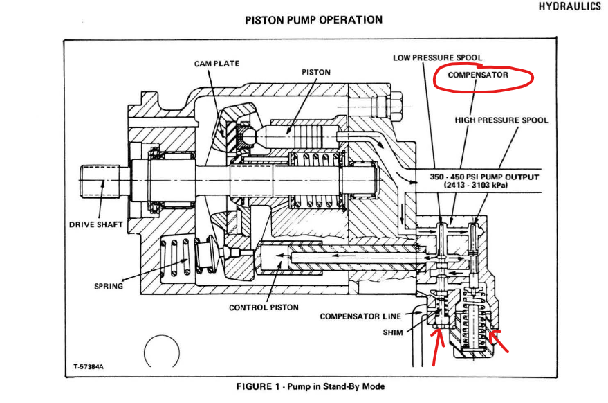

I have a 7060 power shift that has no brakes, pto, 3point, hydraulics, and the steering works, but isn’t right. I bought the tractor with a bad engine, and just split it and coupled a front end on it off a tractor with a bad transmission. I pulled the screen and cleaned it and it was terrible before I put oil back in. Started it and it had brakes and 3 point I know at first. Picked up canister filters after I lost hydraulics and the right filter was backwards. Put new ones in and still nothing. Pressure gauge on the pto valve reads 1000psi sometimes when I start it and 3 point raises, but after that goes to almost nothing and won’t do anything. Any ideas? Piston pump?

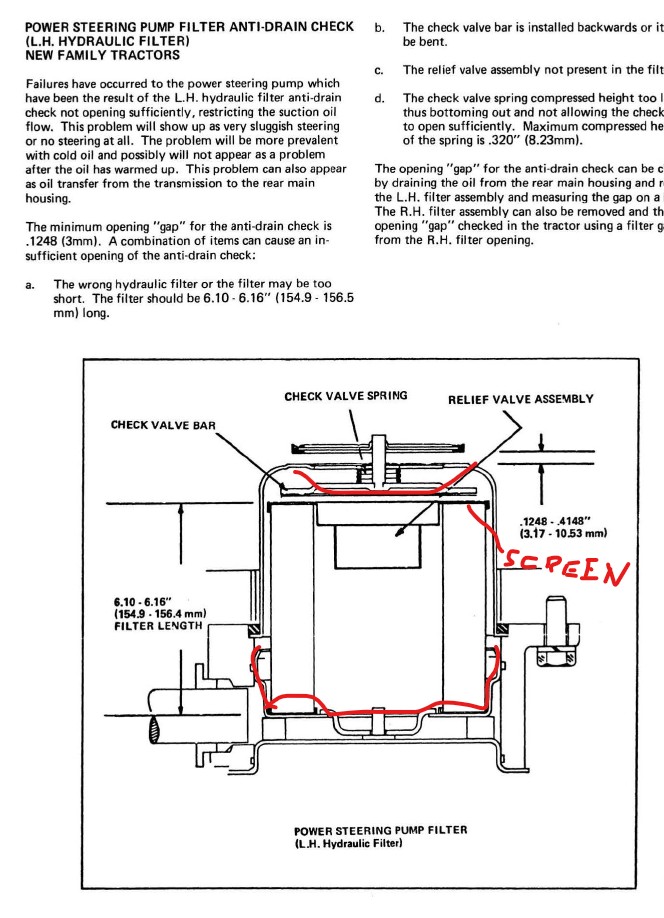

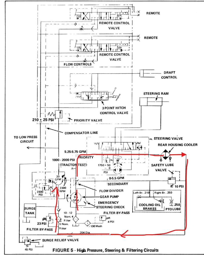

There are other folks on here who know these systems better than me. But having just done a pile of similar diagnosis & repair work on a 7045 (and having learned a lot from helpful folks on these forums), I can comment with some knowledge:
As you probably already know, the 'hydraulic pump' on these tractors is actually three pumps coupled axially together. Going from the rear of the tractor (where they're driven from) to the front, you have:
i)  A geroter pump that pulls from the trans sump and puts trans fluid through the cooler, power-director (if a PD trans), and other tranny paraphernalia.
ii) Coupled in front of that is a gear pump with flow divider, which pulls fluid from the rear axle sump (through the LH suction filter) and puts fluid through the power steering, cooler, second (RH) fluid (and into the surge chamber), and lubricating/cooling oil for the brakes and PTO clutch (note: COOLING and LUBE oil for the brakes/PTO clutch. Not the pressure to run the brakes and PTO clutch themselves - just the cooling/lube).
iii) Coupled in front of that is a variable-displacement, pressure-compensated (closed-centre) piston pump. This runs the remotes, three-point, PTO, brakes, and diff lock.
That's a bit over-simplified, but it gives the Coles-Notes version of everything. Now for your problem: A proper set of pressure gauges and checks is probably in order (which it sounds like you've started already). But because you periodically had brakes, three-point, and steering, I'm going to guess (/hope) that your pumps are whole and working in some capacity. It sounds like oil starvation problems, which are not uncommon on that series. The first thing to check is that you have lots of fluid in the rear end and (most importantly) the correct length filter in the LH housing. This was a well-known/common problem with these hydraulic systems. When installed, the filter 'should' be long enough to push the trap-door (called the 'anti-drain valve' in the manual) open and allow the LH filter cavity to fill. It doesn't push it open much - maybe 3/16" or so. A common problem was that these filters aren't all made the same. You really want to get the AGCO ones. The problem: All companies that make this size of filter make the metal filter-body length the same. But many manufacturers use different gaskets at either end. Most use thinner gaskets, and some use thin gaskets that also fit into a little recess in the end of the filter-body. The AGCO filters have much thicker gaskets adhered to the end of the filter body, making them about 1/8" longer than many/most other brands. If you use one of the other brands, they often aren't long enough to open the trap door and let the filter cavity fill (or rather, they only open it a smidge: They allow a little fluid to come through, but not enough to keep up with the flow demand and it will quickly/periodically starve for oil). Thus: A shorter or non-AGCO filter can cause hydraulic starving problems, resulting in intermittent or no hydraulics.
Coupled with this (I learned this from a local old Allis mechanic) is a problem that can happen to the filter housing components if it's used with the wrong filter: There's a lot of surface area around the trap door and filter end caps. If it's been run with a slightly short filter, it can create enough suction/vacuum on this surface area to bend the end caps in a little, which further compounds the problem as it effectively shortens things even more. When you disassemble the components in the LH filter housing, it's critical to make sure the removable end caps and the bar that pushes the trap door are straight/square. It's also abolutely critical that the screen be installed in the end of the LH filter, as its thickness/length is required to open the trap door sufficiently.
On my 7045 when I couldn't get an AGCO filter for the life of me, I got by for a little bit by making a second disc-shaped gasket our of some cork gasket maker to put in front of the filter and extend it a little, to make sure the trap door was opened sufficiently. I wouldn't want to run for a long period like this (when doing this, you're only relying on spring pressure to hold the filter against the gasket and keep everything in-place. It might last forever like this, but if anything ever went awry I wouldn't want it sucking the cork gasket into the pump). But worked dandy for a short test.
I like my Allis's, but this design (and relying on gravity pressure to keep the filter filled) is not my favourite design. Because you're relying on gravity to force fluid through the LH filter, it's also critical that you have enough fluid in there AND a clean filter. When the filters started to get old/plugged they would cause similar problems, and some folks compensated by just over-filling the rear-end. This created a little more gravity pressure to help force fluid through the LH filter.
So: First step (in my opinion) would be to ensure the LH filter is clean, has the screen on the end, and is the correct length/AGCO filter. At the same time, make sure all components of the filter (end cap, trap door pusher bar) are not bent in any way, to ensure that it's opening the trap door sufficiently far. Also make sure it's well topped up with enough fluid.
After that, I would be suspect of the compensator and priority valves for the piston pump. It's not uncommon for them (not only on Allis's, but on any similar hydraulic system) to get some gunkulence in them and be sticky/jammed. It's fairly simple to take them apart, clean them up, polish the spools, and re-assemble with new o-rings.
Take a look at this note and picture from the Allis manual. Note my sketches in red, which show how the T-Bar and end-cap can get bent over time (especially if the trap door hasn't been opening far enough and it's created a lot of suction pressure).

I took the compensator out and seemed like it moved okay. I pulled it out with my finger. Cleaned it up and put it back in. Nothing still. Is there somewhere else I can test pressure to figure out what’s going on?

There are two compensator spools and springs. Either can cause issues if stuck or broken springs. If they are OK, I might think a broken swash plate spring inside the piston pump. But, if the power steering isn't up to par (cavitation or gear pump failure) it has an effect on the piston pump !! because it charges the piston pump. That's why I keep harping on the power steerings performance.

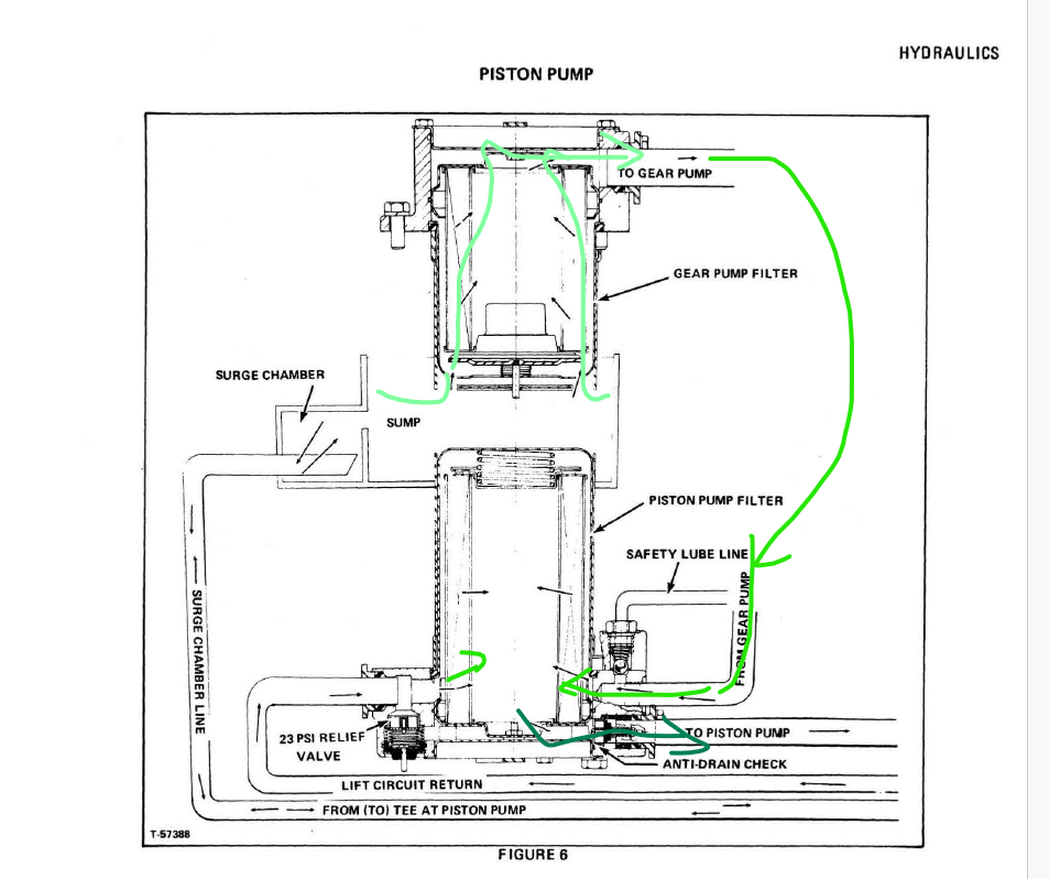

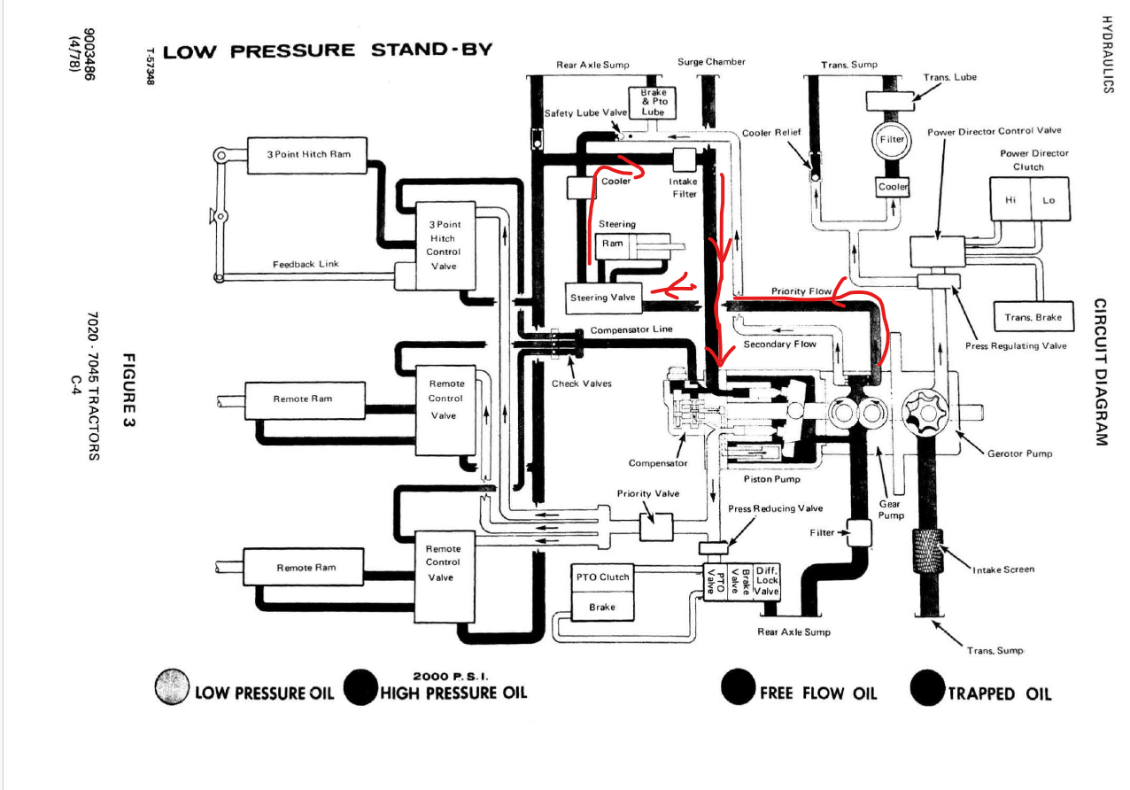

Take a look through these pictures below (sorry for the large size - working off my phone on break here and didn't have the time to re-size). Sounds an awful lot like inlet restriction to the either just the piston pump or gear pump - either with trap door or filter problems. Though a problematic priority/divider valve also sounds like a possible culprit.
You said in your earlier post that the steering was 'working, but isn't right'. Is the steering working correctly now? Or still problematic? More thorough tests are probably in order. But as a quick/dirty start of where to start looking: If the steering seems dandy but the three point and remotes seem awry, I'd be checking out the R.H. filter area again. If the steering also seems wonky, I'd be checking the priority valve spool to make sure it shifts freely, and also re-looking at the trap-door/LH filter.
No matter what, I'd probably still be pulling out the priority spool and making sure it shifts smoothy & easily in its bore. And I'd take the extra shim you added out of the compensator unless you've checked/set relief pressure as well. The compensator affects only the outlet pressure of the piston pump  - the pressure it de-strokes at. Which doesn't really sound like your problem. Again, I'm jumping to some conclusions here and this isn't guaranteed. But it sounds like when the piston pump is getting oil, it's working ok, and thus the compensator de-stroke pressure and relief settings were ok. Sounds more to me like the piston pump isn't getting sufficient oil. I wouldn't be adjusting/shimming compensator de-stroke pressure without ensuring I know what the difference between de-stroke and relief pressure is: This is something to keep in mind on any variable-displacement/closed-centre pump: You always need to have the relief pressure set a little higher than the compensator/de-stroke pressure (usually about 200-300 psi higher, depending on the system). Otherwise you'll just be blowing over the relief and creating lots of heat & excess pumping before it destrokes. Shimming the compensator to increase de-stroke pressure without also adjusting (or at least checking) the relief pressure is a big no-no.
Edited by DanielW - 05 Mar 2026 at 7:41am

Further to my last reply: I never really answered your question of where the piston pump gets its oil from. This is a little over-simplified and I'm sure Dr. Allis will correct me, but the simple version is this:
The piston pump gets oil from the gear pump. The gear pump gets oil from the LH filter, sends it through the priority valve. Priority flow goes through the steering, then through the cooler, then to the RH filter. From the RH filter it goes to the piston pump.
There's also the surge chamber in the rear axle. This is a little chamber with a wall between it and the rest of the rear-end sump. There's a gap in the wall a couple inches from the bottom of the rear axle sump. When running in normal operation, the flow from the gear pump goes to both the piston pump and the surge chamber (the piston pump takes what it needs, and everything else goes to the surge chamber). This is because when you're humming along normally the gear pump delivers far more flow than the piston pump needs. When the surge chamber gets full, it spills over the gap in the wall back into the rest of the rear axle sump.
But the piston pump can, at times, require more flow than the gear pump delivers for occasional short intervals (when using a high demand load on the remotes, for instance). When the piston pump needs more oil than the gear pump delivers, it takes this oil from the surge chamber.
Thinking about it some more, this surge chamber might be part of the culprit in your system. If the gear pump isn't getting or delivering enough flow to the piston pump and surge chamber (either from problems in the LH filter, or because the priority spool isn't shifting properly), then it may not be suppling the piston pump or surge chamber adequately. There may be enough fluid in the surge chamber for the piston pump during the first 10 seconds or so. But once it uses the oil in the surge chamber up, it starves for oil if the gear pump isn't delivering enough. When you shut down for a while, oil is able to ooze its way into the surge chamber - enough to supply sufficient oil to the piston pump for the next 10 seconds or so. How it's getting into the surge chamber could either be from splashing over the wall from the rest of the rear-end housing (if it's filled higher than the wall), or slow leak-through some other part of the system.
Again, that's over-simplified and the Doc will likely tell you better advice than I can. But if it were mine I'd be first checking the priority/divider spool (easy to do on the tractor). If that doesn't do it, I'd be looking again at both LH & RH filters to make sure everything's how it should be.
If that doesn't do it, deeper diagnosis is required. Could be stripped splines between gear and piston pump as suggested above. Or problems in the piston pump/compensator. Or a host of other problems. But if it were mine I'd be crossing my fingers and start with the easy/common issue of the divider/priority valve spool sticking in its bore or lousy flow through the filter housings.
Edited by DanielW - 05 Mar 2026 at 8:07am

If it was mine to repair, I'd just remove the piston pump and tear it apart. I'll bet there's a broken swash plate spring or something related to the swash plate de-stroke piston. You don't really have to drain any oil, but have plenty of plastic caps/plugs to plug holes to keep the oil where it belongs.

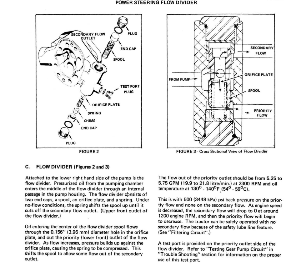

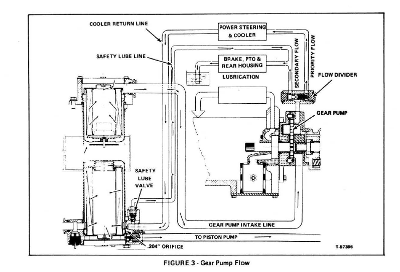

I'm going to add one more point to my earlier reply: Earlier in this discussion it was suggested to take out and check the priority/divider spool to make sure it's shifting freely and easily. You then mentioned that you '...took the compensator out and it seemed like it moved ok...'. Did you actually mean the 'compensator' spool, or did you mean the 'priority' (or 'divider') spool? Two different things. And there are two compensator spools. While the Doc is likely right that it's time to pull the piston pump, as mentioned above I'd probably start by pulling and checking the priority/divider spool if you haven't yet done so. Quick and easy to do with the pump in place on the tractor.
First pic is the priority/divider assembly (on the side of the gear pump). Second is the compensator (on the front of the piston pump).
Edited by DanielW - 05 Mar 2026 at 9:22am
