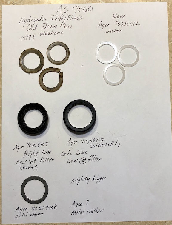

Heres a pic of parts I replaced.
The hydraulic drain plugs were an easy swap. Pic shows old ones across from new ones.
The hydraulic line seals were puzzling though. I foung that it's Left side hydraulic line(pipe) is larger diameter than the Right side hydraulic line. I had spec'd all my necessary parts online at agcopartsbook.com & then drove 70 miles to AGCO parts dealer to get them. But when I disassembled these two hydraulic lines to reseal them, I noticed their size difference.  I know,,, should have taken old worn parts with me to dealer..  AGCO online states the same rubber seals & their metal backing washer for each of them....?
Anyway with new AGCO parts in hand, I was able to stretch 70259407 rubber seal over the larger left line & re-use its old larger backing metal washer. Just curious if anyone knows correct AGCO part for that larger left line's metal backing washer?
The right side hydraulic line had 2 sets of seals on it? After careful inspection, that pipe's exterior had a worn area where seal resided.  Figured someone before me, must have double them up to address that issue? So, I also doubled them with new seals/backing washers.

Post Options Post Options   Thanks (0) Thanks(0)   Quote DrAllis Quote  Post ReplyReply Direct Link To This Post Posted: 12 Nov 2025 at 2:11pm
Left side tube was always a little larger than the right. My quick NASCAR pit stop fix was always remove the two bolts, slide the metal squeezer forward, find an Oring of the proper diameter, make one cut in it, slide it on the tube and reassemble. When the oil was drained out, I would fix it the right way, but a leaker that needed a quick fix this always worked quite well.
