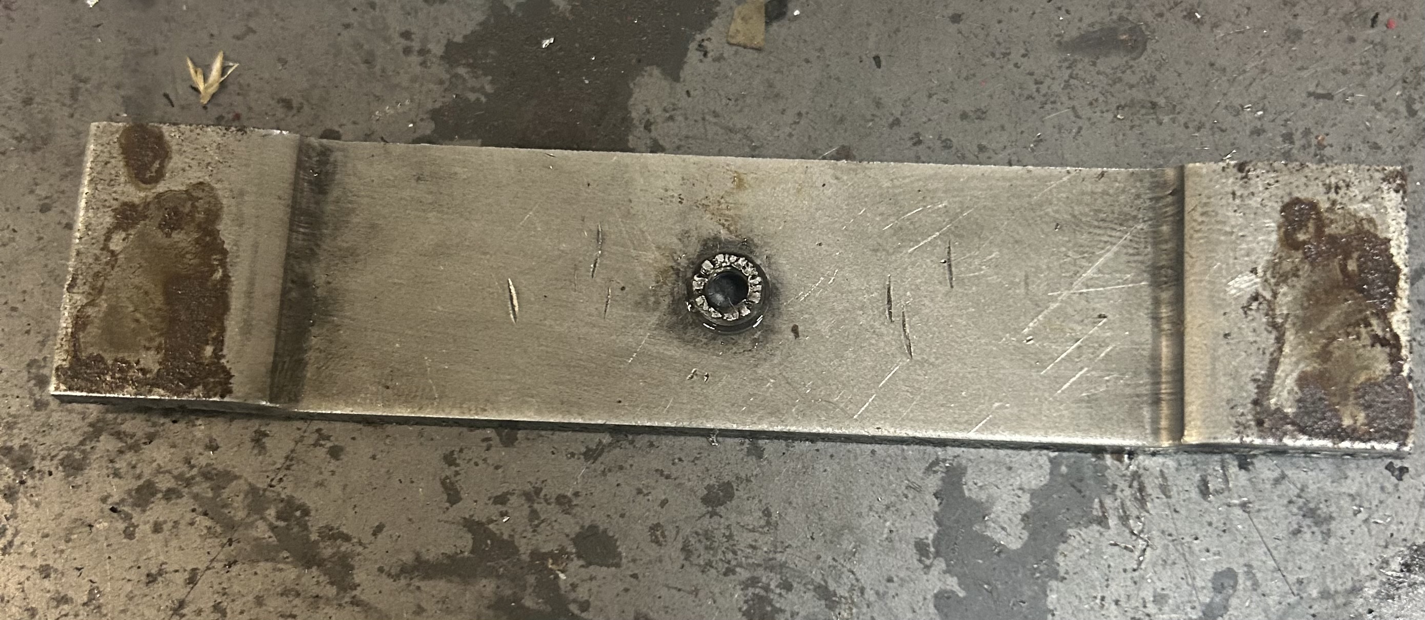

Post Options Post Options   Thanks (0) Thanks(0)   Quote AC 426 power Quote  Post ReplyReply Direct Link To This Post Posted: 12 Jan 2024 at 7:16pm
definitely a messy job, but got it drained and I found this in the filter housing.
