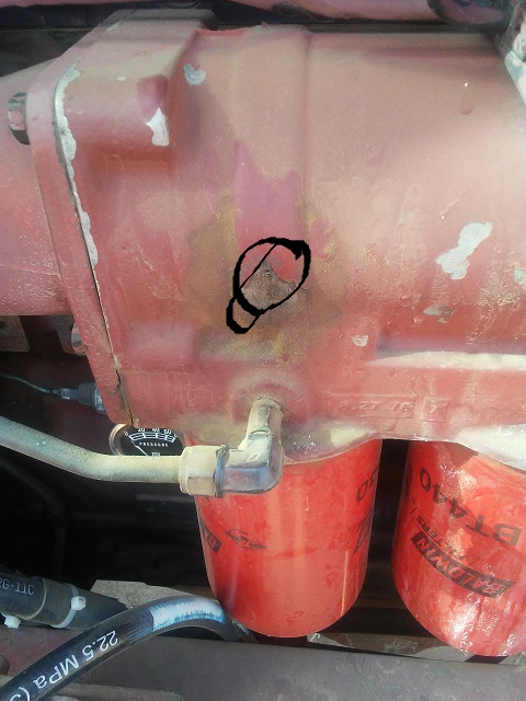

Next ,, the oil cooler is seeping coolant out of a "weep" hole at the rear of the oil cooler, so far there is no mixing of oil and coolant. I have ordered O-rings and gaskets, looks like this repair is not to complicated,, just like to know if there are any "watch out for" ...
I'll have the cooler tested if I can find some place that will test it...

When you get it apart, make sure you clean all of the cooling tubes completely. It always surprises me how much stuff gets plugged into those things.

When you press cooler out of housing, be real careful not to bend edges where o rings seal.
Put the correct oring in the correct location. Two are for violent, two are for oil.      MACK

AGCO parts shows the restrictor orfice is in the inlet of the luberfiner filter case, also shows check valves in the in and out lines,,, do I need to keep the check valves in the system also??
the black circled hole is where its leaking coolant..
any special lube on the O-rings??

The weep hole is normal. All of the 426 engine coolers have one. It just lets you know when you need new o-rings.
I have seen some guys braze or weld them shut.

I figured that weep hole is supposed to be there,, jus like the ones on water pumps and the early 4020 JD's,..to let ya know that the o-rings are failing/worn out....heard of people doing the same thing on the deere's...plugging, welding, etc...

The hole is to let pressure out and not try to compromise the other o-ring
