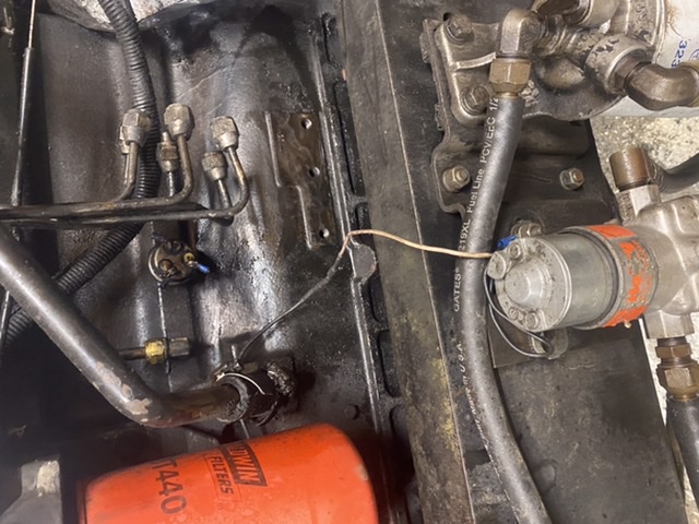

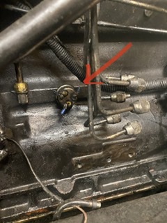

I have a 7045 with a serial number of 3792. I have wiring diagrams that I found in shop manuals. well I guess the only way to try and explain this is to add a picture. Be advised this is not my doing this is the way I purchased the tractor. I know it is in the oil pressure sending unit. But nowhere in any manual can I find a three wire oil pressure sending unit. Or how it was wired!   Obviously I have the injection pump out

It does have a lift pump on it. In my limited mechanical knowledge I believe someone hardwired the lift pump to the key. Confused  Turn the key on lift pump starts running if I’m not mistaken the sending unit should be wired in and the lift pump should not start running until there is oil pressure.

Anyway, I would just put a two wire sending unit on which is normal for the tractor.

Electric pump fired by the key. Oil pressure sender is ONE wire.

A two or three wire pressure switch is usually for a gauge not a light.                 MACK

AGCO part # is 74021445 one wire only back of oil filters

Post Options Post Options   Thanks (0) Thanks(0)   Quote GM Guy Quote  Post ReplyReply Direct Link To This Post Posted: 12 Apr 2022 at 10:44pm
That sure looks like a sending unit off a combine. Any chance the motor was swapped out of a combine? Depending on how much of a perfectionist the swapper was, it either has a modded front plate to get the mounts or they swapped the front plate.
Also, that is a factory lift pump and mounting bracket, but they dont put them outside the framerail like that. the 1981 units were the only factory installed ones, all older it was a kit. framerail was notched slightly for the filter. all were on the inside.
