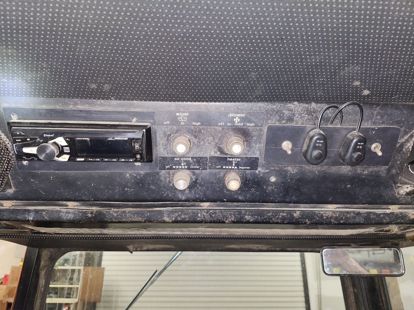

Post Options Post Options   Thanks (0) Thanks(0)   Quote plummerscarin Quote  Post ReplyReply Direct Link To This Post Posted: 19 Jun 2025 at 10:35pm
My 7060
New radio relocated to the left with a new panel I made. Then fabbed a radio delete plate for the original opening. Toggle switches secure the plate through the old radio knob holes and the push buttons are for LED light bars
