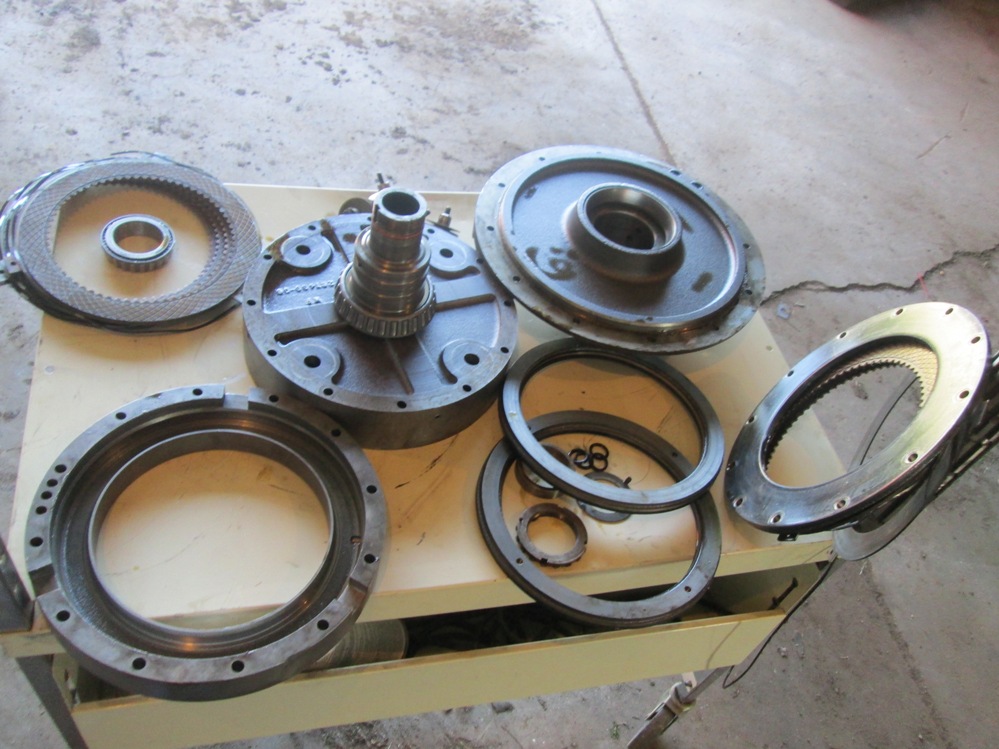

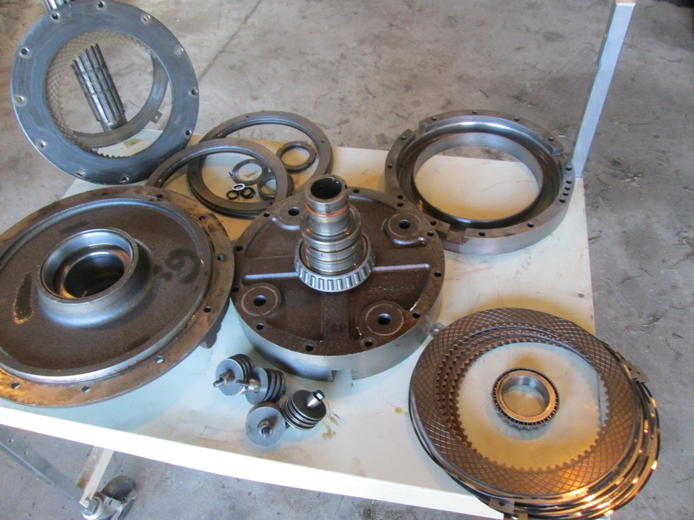

Makes a difference if the slippage is in HIGH button or LOW button. A pressure gauge on top of the clutch valve should monitor what the clutch system is doing. 195 to 205 psi is spec at full throttle. Cab certainly never needs to be removed. Engine rolls away and clutch comes out thru the bell housing. You are nowhere near that point yet until problem is diagnosed properly first.

I consider the power director clutch on that series to be extremely tough and reliable. Given the age of the tractor, I guess that anything is possible. It would be very rare for both sides to be slipping unless there was low oil pressure being supplied to them. If one side is slipping, due to leak in that particular side, then the pressure light should indicate it. The rubber piston seals can get hard and brittle and cause poor engagement. If either side has been slipping for very long, then the clutch plates will warp. Warped clutch plates make it difficult to get into gear without grinding. The small transmission brake disc can't stop the momentum of the power director assembly. It's not that difficult to remove the PD assembly once the tractor is split. Clean oil, filter and then pressure checks are first.

No, the higher horsepower tractors have more clutch plates and the 7080,7580 used 6 spring washer stacks to return the low side piston. I believe that the complete clutch pack assembly from a higher horsepower tractor can be used in the smaller models.
Points: 22172
Post Options Post Options   Thanks (0) Thanks(0)   Quote DrAllis Quote  Post ReplyReply Direct Link To This Post Posted: 14 Oct 2024 at 8:44pm
7010-20-30-40 all have the same clutch with 3 discs in low (inching) range and 2 in high range.  7045-50-60 are the same and have 4 discs in low (inching) and 2 discs in high.   Early 7080's were 4 and 2 with the low range separator plates are thicker to take more heat. Later 7080's were 5 and 3 if I remember right.  There is nothing under designed on your 7030 clutch assembly. If the entire system is up to specs it will work fine. I used to tractor pull a 7030 in the late 1970's with 300+ HP and never had any issues at all.
