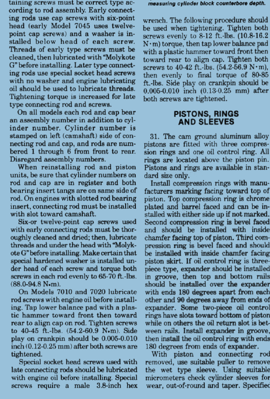

Post Options Post Options   Thanks (0) Thanks(0)   Quote nowaktj Quote  Post ReplyReply Direct Link To This Post Posted: 4 hours 47 minutes ago at 1:05pm
This is what the service manual states but is it accurate?   I am also working on a 7020 engine (Out of a M2 combine).
Edited by nowaktj - 4 hours 46 minutes ago at 1:06pm

Post Options Post Options   Thanks (0) Thanks(0)   Quote nowaktj Quote  Post ReplyReply Direct Link To This Post Posted: 4 hours 40 minutes ago at 1:12pm
I bought new rod bolts from AGCO.   I looked at the head of the bolts and they are stamped with "EMP" and "170M".
Here is a post I found from 2015:   301CI allis motor model 649T - AllisChalmers Forum
D19D, D17D, WD, WC, Snobee, #83 Plow, SC Blade, 14' disk, 400 series planter, B , Terra Tiger, M Dozer w/Baker Blade, TL-12, 42S Grader, G

Post Options Post Options   Thanks (0) Thanks(0)   Quote DrAllis Quote  Post ReplyReply Direct Link To This Post Posted: 4 hours 11 minutes ago at 1:41pm
80-85 ft lbs for 301 rod bolts is toooo much !!   Must be an I & T book ??
