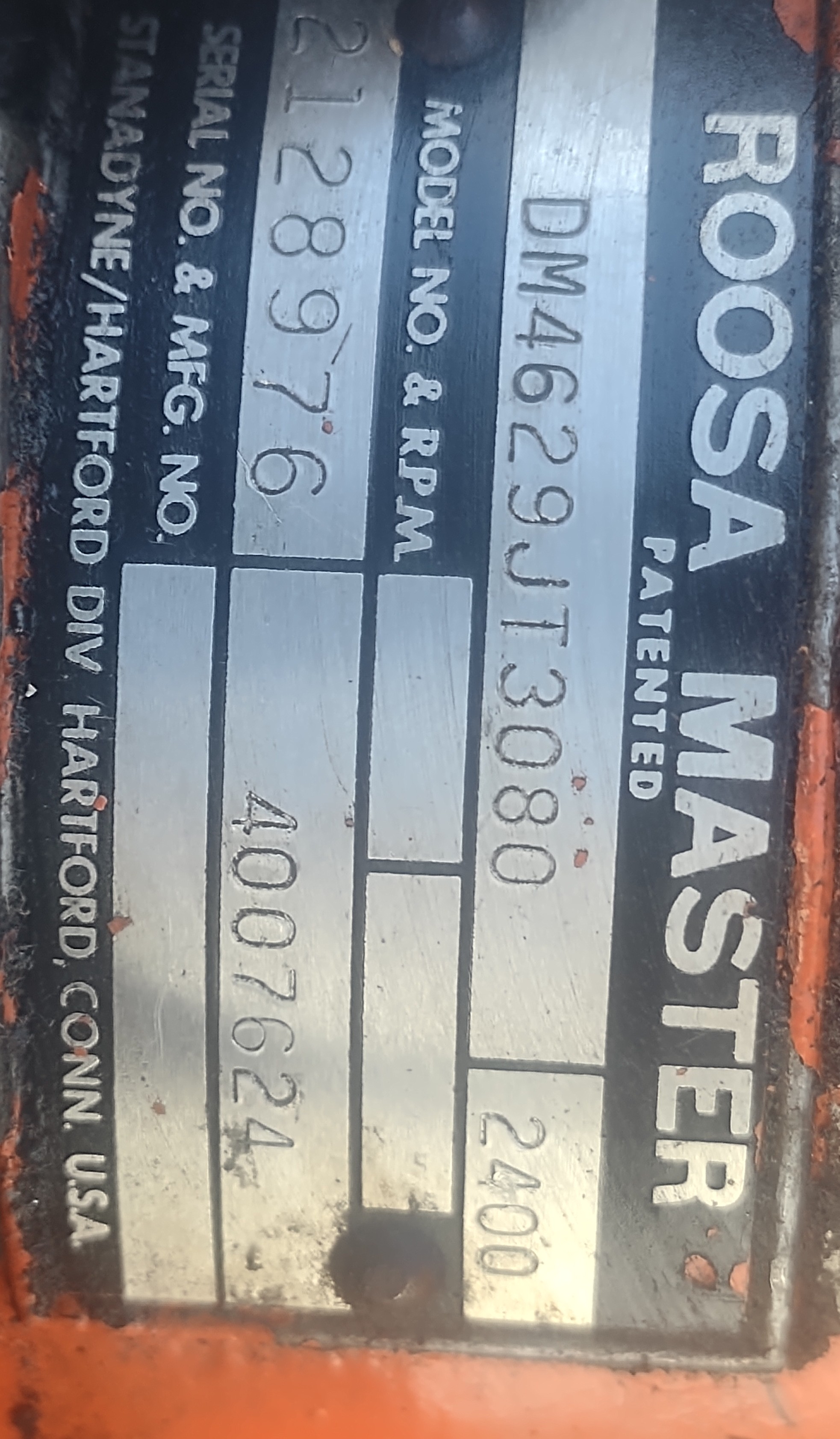

Many times Roosa pumps tend to gum up from sitting if running bio diesel, and it is allowed to sit and age, it doesn't age well. Think of a jug of milk being 6 months old. I rebuild lots of pumps here. That is an M2/L2 pump. It could be made correct for a 7020 when rebuilding.
Edited by injpumpEd - 13 Feb 2023 at 1:58pm
Would you be interested in taking a look at this pump if I shipped it out? Would like to pick your brain on a few things with it.
