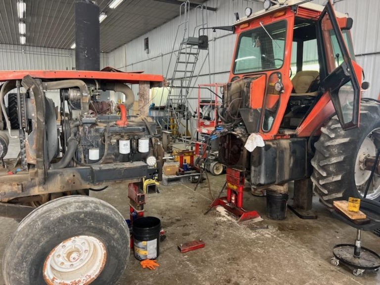

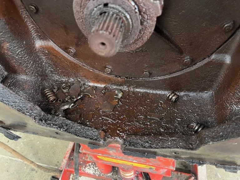

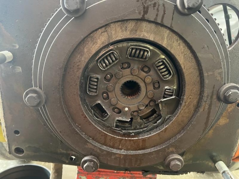

Post Options Post Options   Thanks (0) Thanks(0)   Quote calico190xt68 Quote  Post ReplyReply Direct Link To This Post Posted: 04 Jun 2025 at 11:10am
The 7010 has been split and the culprit discovered.
See pictures.
Here is the comment from the Agco Technician for those interested.
And yes someone has definitely been in there . They doubled up the belleville washer and then tried to shim it out with lock washers (those spacers have a .040 variation in height.). I'm guessing that's why if failed, it was too tight and had no give (( you know what its designed to do))
Points: 22568
Post Options Post Options   Thanks (0) Thanks(0)   Quote DrAllis Quote  Post ReplyReply Direct Link To This Post Posted: 04 Jun 2025 at 11:15am
Depending on how many hrs are on that torque limiter, I could speculate that it wasn't perfectly centered in the flywheel. They must be "seated in" upon fire up after being replaced. If they aren't slipped at least a little, the disc splines aren't centered with the clutch shaft causing a fairly quick failure and wear on the clutch shaft splines.
