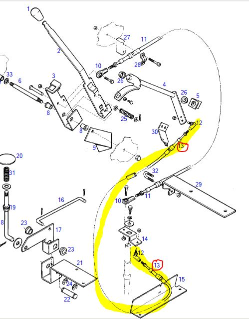

My 7010 PD won't go in to low range.  Just stays in neutral.  Sometimes by shifting a bunch between High and Low, it will finally catch.
Is this a cable problem, and is there an adjustment?
Thanks,
Roscoe.
Points: 22315
Post Options Post Options   Thanks (0) Thanks(0)   Quote DrAllis Quote  Post ReplyReply Direct Link To This Post Posted: 12 Dec 2016 at 12:06pm
Probably the small side-shift cable is stiff/sticking. Adjust all you want, but replace the cable first.

I don't have a parts book for this.  Can I find the part number on-line somewhere?

agco partsbooks online, sign in as a guest, and see everything.

Post Options Post Options   Thanks (0) Thanks(0)   Quote Roscoe62 Quote  Post ReplyReply Direct Link To This Post Posted: 12 Dec 2016 at 12:44pm
That did it!  By the small side cable, I assume that is the one on the bottom of the shifter?

Yes.

my heim joint split.   got mine back together and welded it.   cleaned threads and it works like new.   pull the floor pan, it will tell u the story
