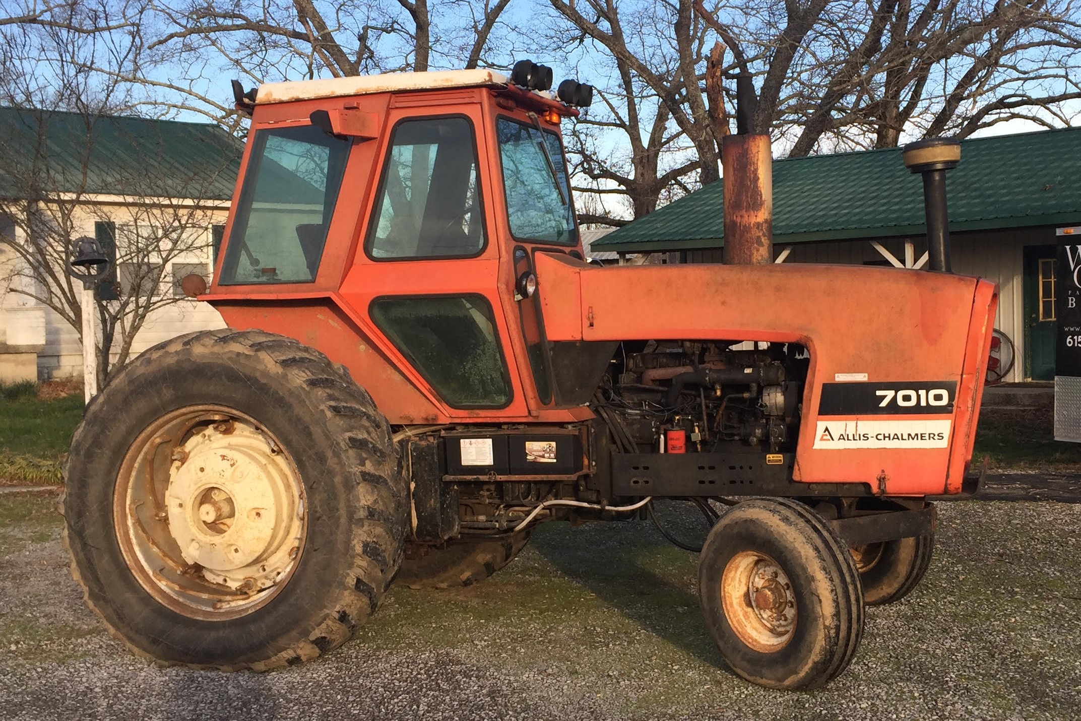

Thanks for all the replies, I appreciate all the experience that the members here share. AC system needs a complete rework, radiator has partial left on the foam kit

Thanks for sharing your 7010's photo. Its looks like a good straight tractor. I see its got the nice stadium lights & remote mirrors. No power-shift decal on the door, so I'm assuming its got the 20 speed power director. You're going to enjoy those power shift rear rims when making quick wheel adjustments if you hook up an in furrow AC 2000 monobeam 5-16 plow, working hay, etc... Did you get any duals with it?

20 speed PD and no duals, a few items need work but seems solid mechanically

That is a nice 7010! Was well looked after!

And I just ordered new 18.4R38 Michelin Agribib radials from www.petestirestore.com for mine.
Less than 2500 delivered for both.
Looks like you may need some soon.

Walked by it this morning and 1 rear was flat and the other was low...  Looks like tires may have moved up the list
