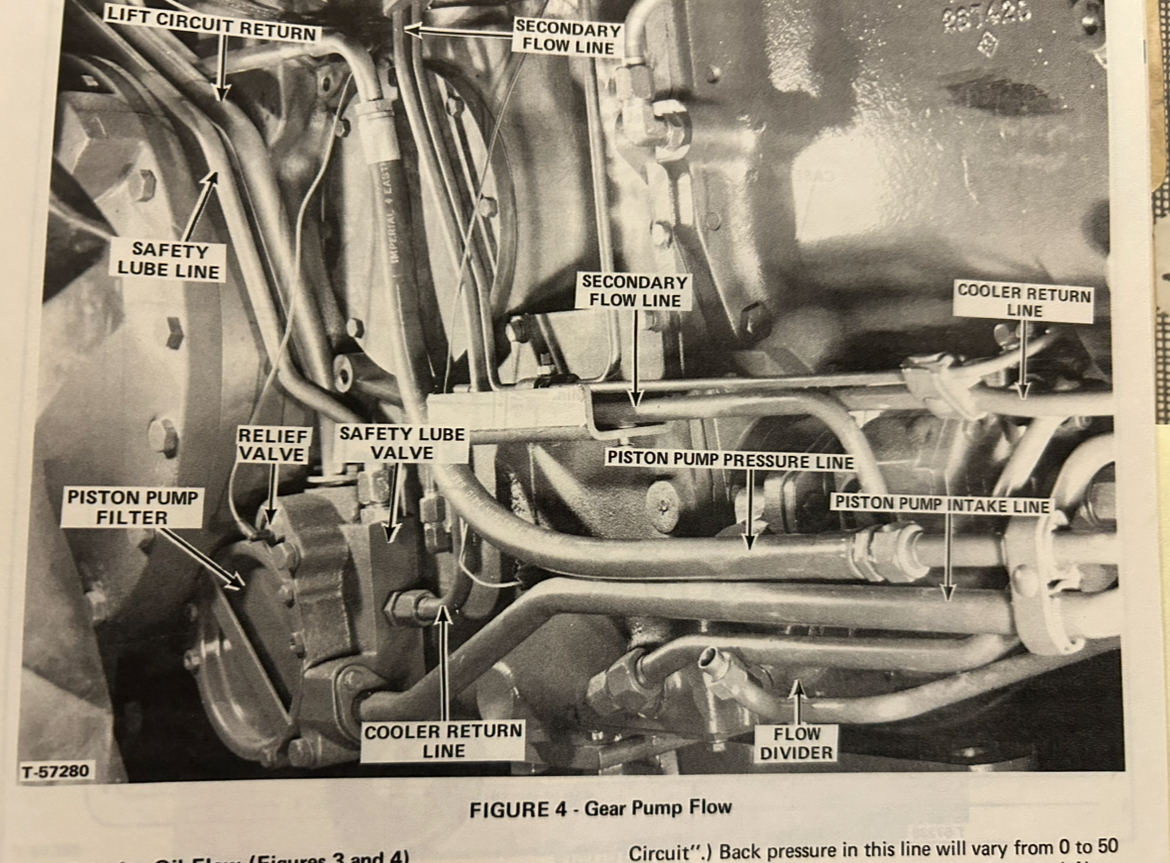

I have a loader on my 7010 that currently runs off 2 remotes. In an effort to simplify control and free up the remotes, I’m adding a dedicated loader control valve and a joystick. Will I be able to T into the pressure line coming out of the piston pump to get my loader supply oil, or does the oil have to travel through the priority valve behind the cab first? I’m trying to make sense of what the book says about sending oil through the compensator line to stroke the pump, and it’s making me think I can’t tie in down by the pump, but I wanted to make sure.

You need a closed center load sensing valve. You need to tee into the compensator line to stroke the pump. Where to send the return oil is the next question. Good luck with your project

Sorry but no sir. It has to be a load sensing valve that had a signal line to go to the compensator on the piston pump
