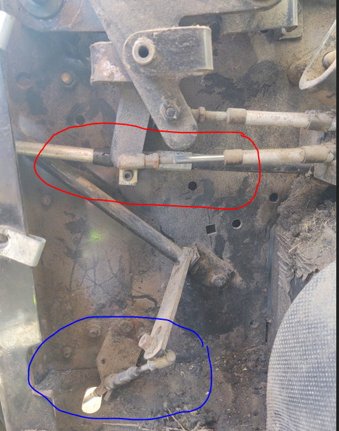

I have a 16 speed power director 7010.  I started putting some equipment away in the barn for winter.  Was shifting out of low into park and got half way out of low and the lever got stuck.  Can't move it forward or backward.  Tractor won't move either so it is not in gear.
I have had a little trouble shifting into park lately so this problem may have been waiting to happen.   I don't know much about this setup but my guess is that it could be the park cable is stuck or it could be the hi/lo cable is stuck.  Worse case scenario is the shift fork in the transmission?  I think I need to disconnect the park cable and see if that allows movement.  If it doesn't then disconnect the hi/low cable and see if it moves.
Most importantly, looking for steps to debug the problem.  Any help is appreciated!
Here is a picture of the shift cable area.  I used red for the hi/low cable that looks a little bent to me, and I think the blue is park cable?
Last, the dang tractor is half in the barn.  Can I pull it out about 10 feet so that I can shut the door?

You'll probably need to remove the floorboard of the cab to get to the real shift lever.  If you disconnect the large cable down below and now your lever in the cab moves again, it ain't the cable. The large cable does the front to back movement and really all the work. The small cable is the side shift cable and directs the under the cab lever to the Park rail or the LOW-N-HIGH rail.  I think you have shifter problems inside the shifting cover behind the small fuel tank.

All right thanks for the help.  I will remove the floor board and disconnect cable and see what happens.

Happy to report that I have resolved this issue with the help of the forum.  It ended up being a sticking hi/low main cable.  My steps were:
I removed the cab flooring, then the metal plate, and then the screw that tied the cable end to the final shift link.  After shifting it, it was still stuck, but I noticed it moved a little.  That convinced me this was not shift fork issue but rather a cable problem.  I put some wd-40 on the end under the cab, then moved it back and forth and it broke loose.  It looked like it was in a bit of a bind but has to be corrosion in the cable.  I reconnected and was able to place into high, low and park.  Tractor moved as expected.  I still think it shifts hard so would like to replace the cable and be done with it since I have it all apart.  Worried it might stick in the dead of winter when I really need it.

I looked at that u clamp and I don't know if I should loosen from the back of the tractor or try to loosen from within the cab.  Both paths look pretty hard to get to and limited space for a wrench or socket.
Points: 22049
Post Options Post Options   Thanks (0) Thanks(0)   Quote DrAllis Quote  Post ReplyReply Direct Link To This Post Posted: 02 Nov 2020 at 8:11am
Unbolt the U-bolt anchor plate and then position it where you can wrench on the U-bolt easier.
