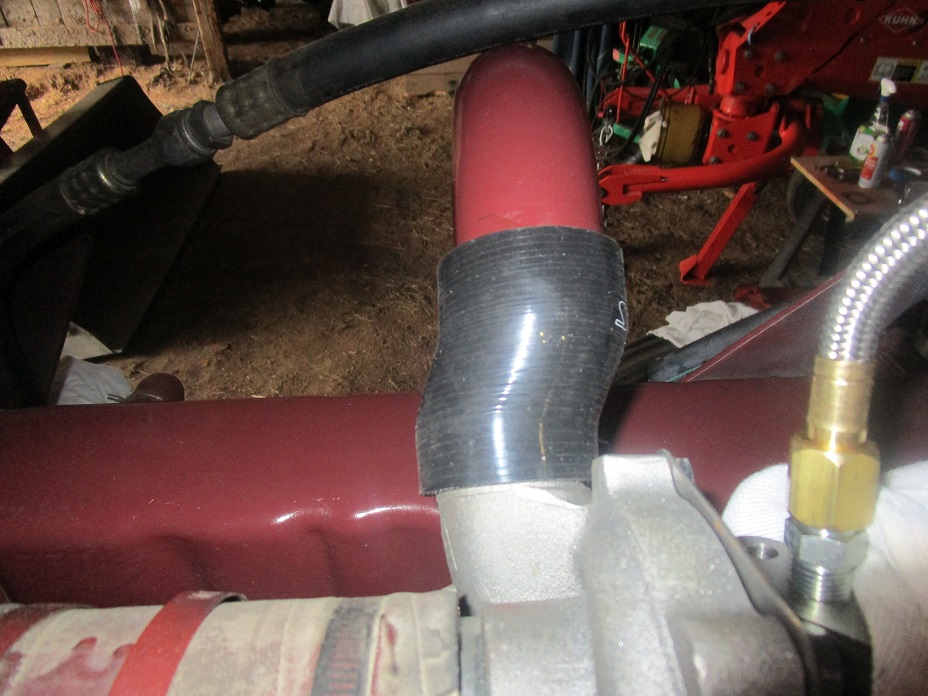

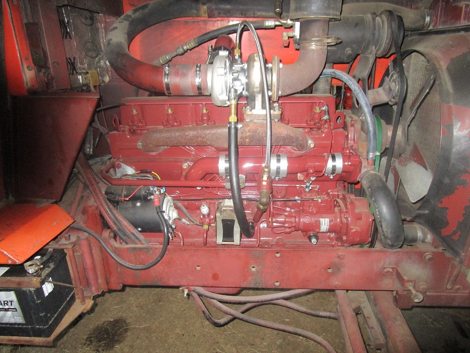

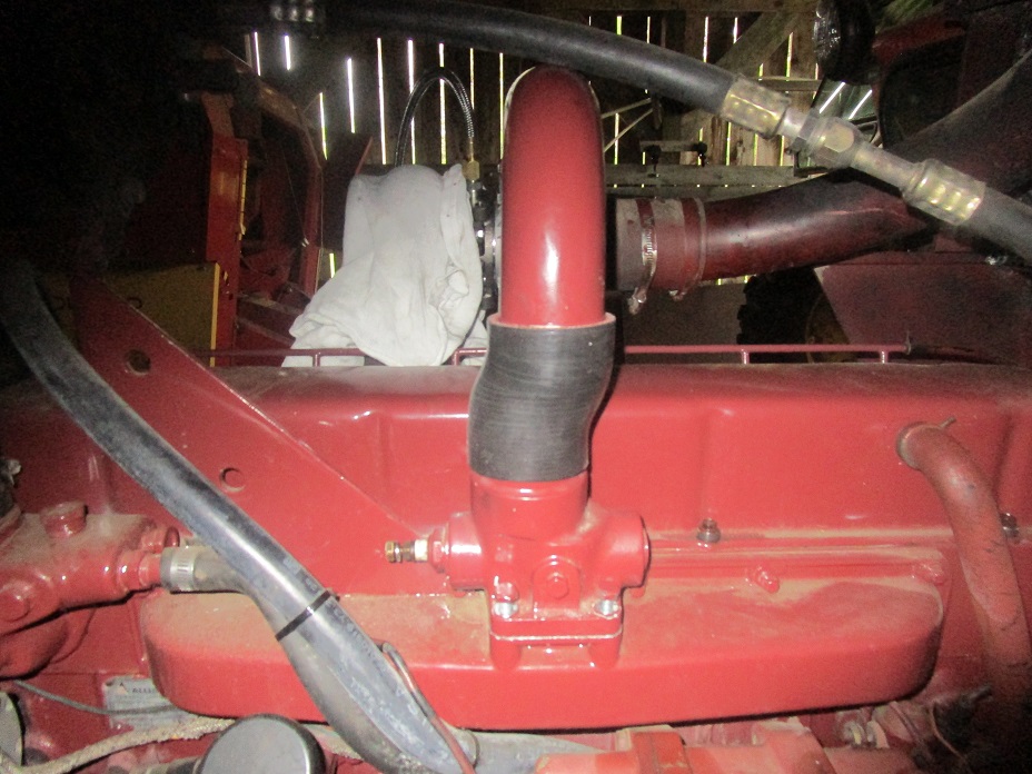

I have been wanting to follow up on this project, been busy haying. Because the new turbo is bigger in the middle, I found I was off by an 1" for the charge pipe to make up. So I found a company in CA, that make off set silicone couplings. HPS - Manufacturer of High Temp Reinforced Performance Silicone Hoses , Aluminum Tubing & Stainless Steel Clamps So then I cut the pipe above the intake pre heater. In the pictures you can see it fabbed up.   Tim

   Can’t you just turn the air heater box 180*. If I remember correctly the air heater element faces to the rear.

The preheater is on correctly,the bolt holes pattern is offset,so it will only go one way.

A lot of extra messing around, but will be a better turbo, and now easier to replace down the road in another 20 years lol! Looks great Tim!

Thanks Ed. That charge pipe in mandrel bent. So I cut the pipe as far up as I could, and still have the clamps on a flat surface. The next project on the tractor is the brakes.  Tim
