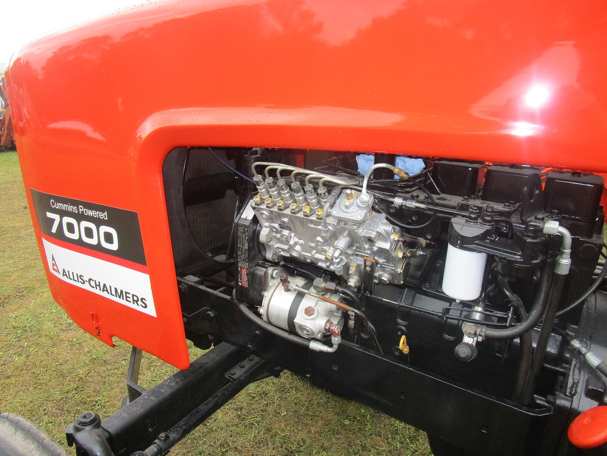

You couldn't walk by this tractor without checking it out.

It was a really nice machine!

Looks good

Very sweet !

It looks like a good fit, someone did a really nice job !!

Great restored AC 7000. Pretty paint job. Thanks for sharing. Photo says it had just showered/rained with water drops on lower edge of orange hood & explains the blue shop towel to soak up water from hood exhaust opening.
Thinking it’s a pulling tractor if it has a Ppump?? Don’t think an ordinary 7000’s drivetrain would hold up to a Ppump 5.9 Cummins?

Oh it would if you dont pull the guts out of it - I  think those were factory at around 185 hp; still more than an AC 301

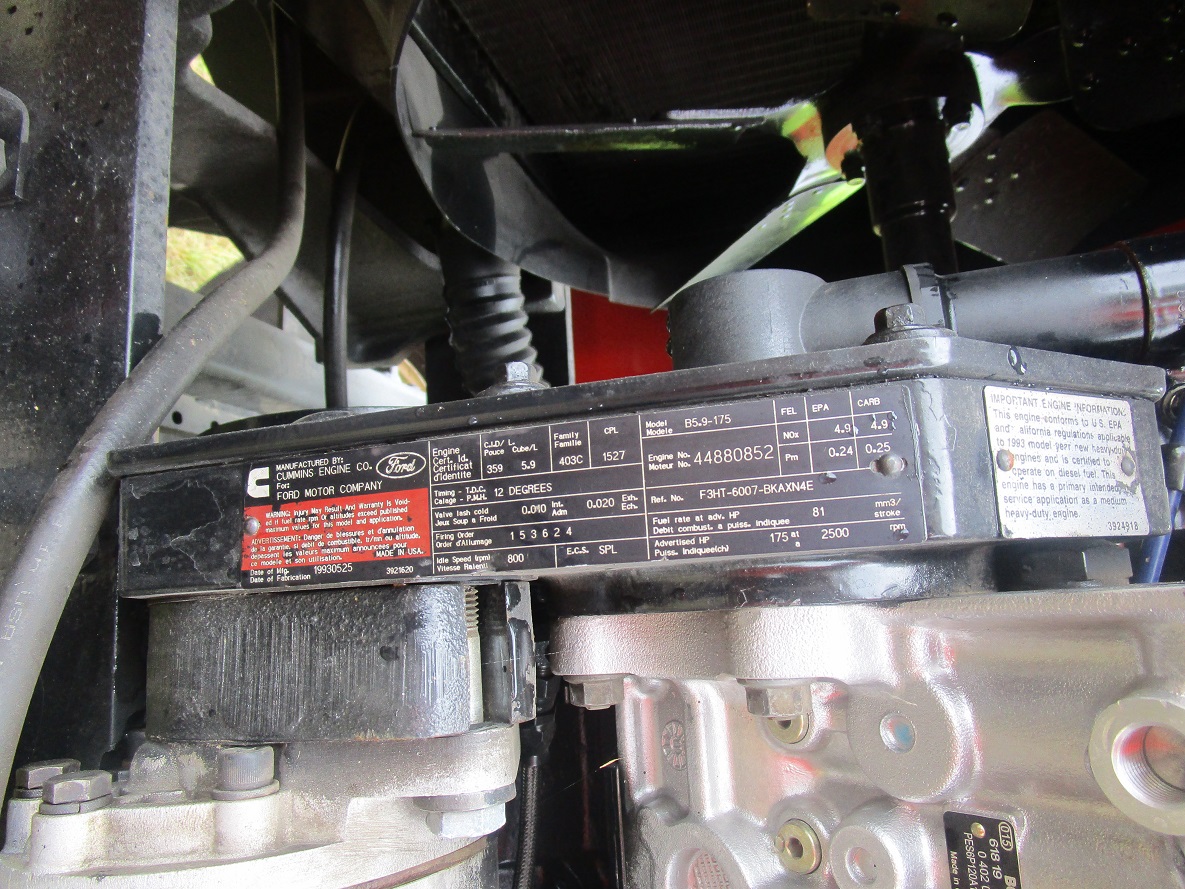

I should have put this photo on too.

What did Ford have a 5.9 Cummins in?

I just see it says manufactured by Cummins Engine Company for Ford Motor Company, that's why I was asking.

5.9 Cummins engine ID tag says “19930525(May,25,1993)Mfg date. So it likely came from a mid-duty 1993 Ford F700 chassis truck?
The AC 7000 owner did a great job of mounting the hydraulic pump below the Ppump.
The 5.9 Cummins 175hp vs AC 7000’s 649T 106hp doesn’t concern me as much as their torque differences, 5.9~400+ vs 4.9~240?

I wasn't thinking that far back, but that would make sense.

  The hole under the Injection pump is a standard "B" mount and if a standard drive gear can fit the shaft of a needed pump it will bolt right in. For the power steering in the Oliver I swapped a cummings into, the pump has a splined shaft so all I needed was an adapter gear with a splined hole and matching spacer housing with a bearing in it.
