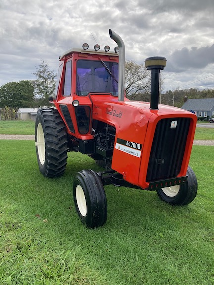

Points: 8735
Post Options Post Options   Thanks (0) Thanks(0)   Quote Mikez Quote  Post ReplyReply Direct Link To This Post Posted: 13 Oct 2021 at 7:37am
are we going to see a picture of the new tractor.
Where abouts are you putting the new shed.

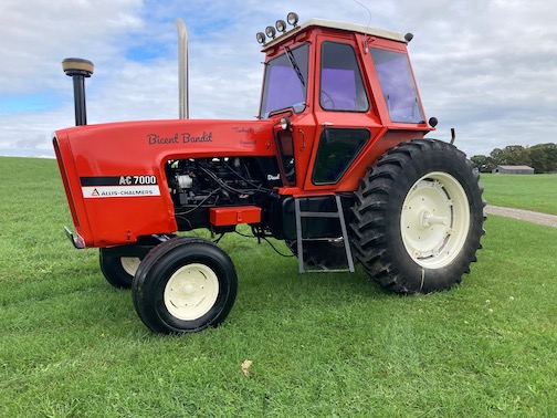

captaindana View Drop Down
Location: Fort Plain, NY
Points: 2573
Post Options Post Options   Thanks (0) Thanks(0)   Quote captaindana Quote  Post ReplyReply Direct Link To This Post Posted: 14 Oct 2021 at 5:25pm
Mikez I’m adding westward When the weather turns cold her and things calm down a bit you’ll have to come up with your dad

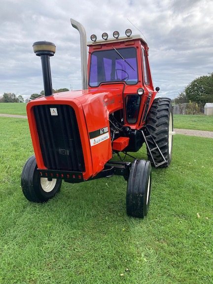

DanWi View Drop Down
Joined: 18 Sep 2009
Location: wttn
Points: 1939
Post Options Post Options   Thanks (0) Thanks(0)   Quote DanWi Quote  Post ReplyReply Direct Link To This Post Posted: 04 Nov 2021 at 9:49pm
Looks good. Did you get your leaks stopped? what were they?
