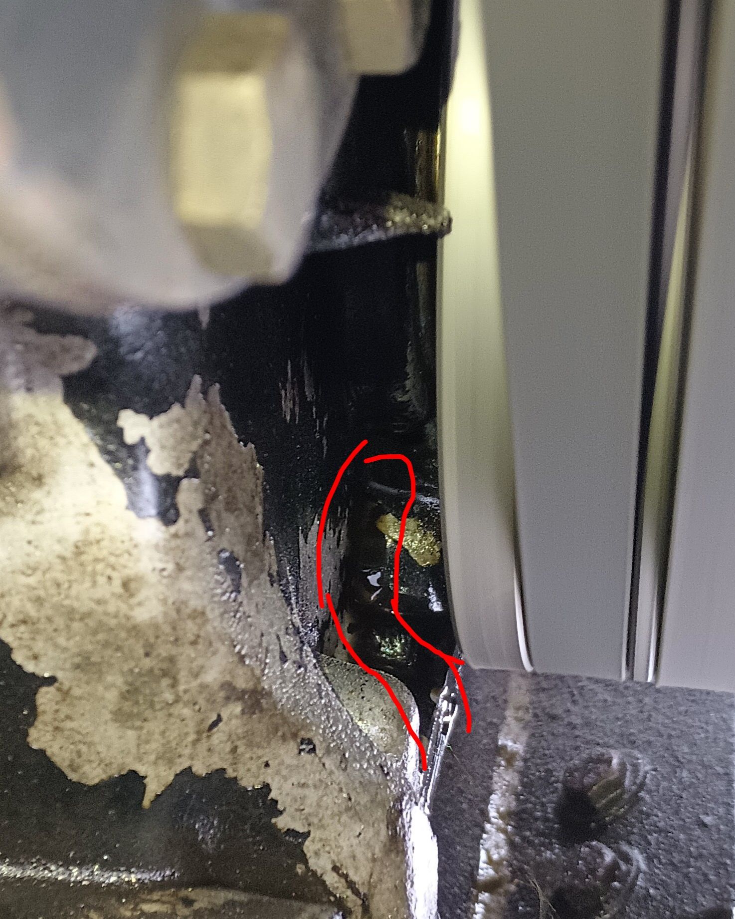

Post Options Post Options   Thanks (0) Thanks(0)   Quote Northern Hoser Quote  Post ReplyReply Direct Link To This Post Posted: 28 Jan 2026 at 2:40pm
So here's the right side, has oil above the oil pan on the cover, hard to tell exactly where it's coming from but I'll double check the pan before getting in there

Post Options Post Options   Thanks (0) Thanks(0)   Quote DrAllis Quote  Post ReplyReply Direct Link To This Post Posted: 28 Jan 2026 at 3:30pm
Cracked cover ....??

Post Options Post Options   Thanks (0) Thanks(0)   Quote Northern Hoser Quote  Post ReplyReply Direct Link To This Post Posted: 28 Jan 2026 at 5:04pm
I'm wondering that myself. I gotta have a better look but didn't look like it was wet at the bottom of the seal and there isn't any oil being slung out by the balancer.

Post Options Post Options   Thanks (0) Thanks(0)   Quote SteveM C/IL Quote  Post ReplyReply Direct Link To This Post Posted: 29 Jan 2026 at 10:25am
Get everything clean and dry (Brake Clean)and watch closely. A fan can move the oil around making the leak appear to be somewhere it's not.

Post Options Post Options   Thanks (0) Thanks(0)   Quote Northern Hoser Quote  Post ReplyReply Direct Link To This Post Posted: 31 Jan 2026 at 2:58pm
So after cleaning things up and checking again, the windage from the pulley is moving the oil around a bit, but it is indeed coming from the seal and then running across the cover where it's seen in the pic. I'll update when we get in there a finally fix it.
