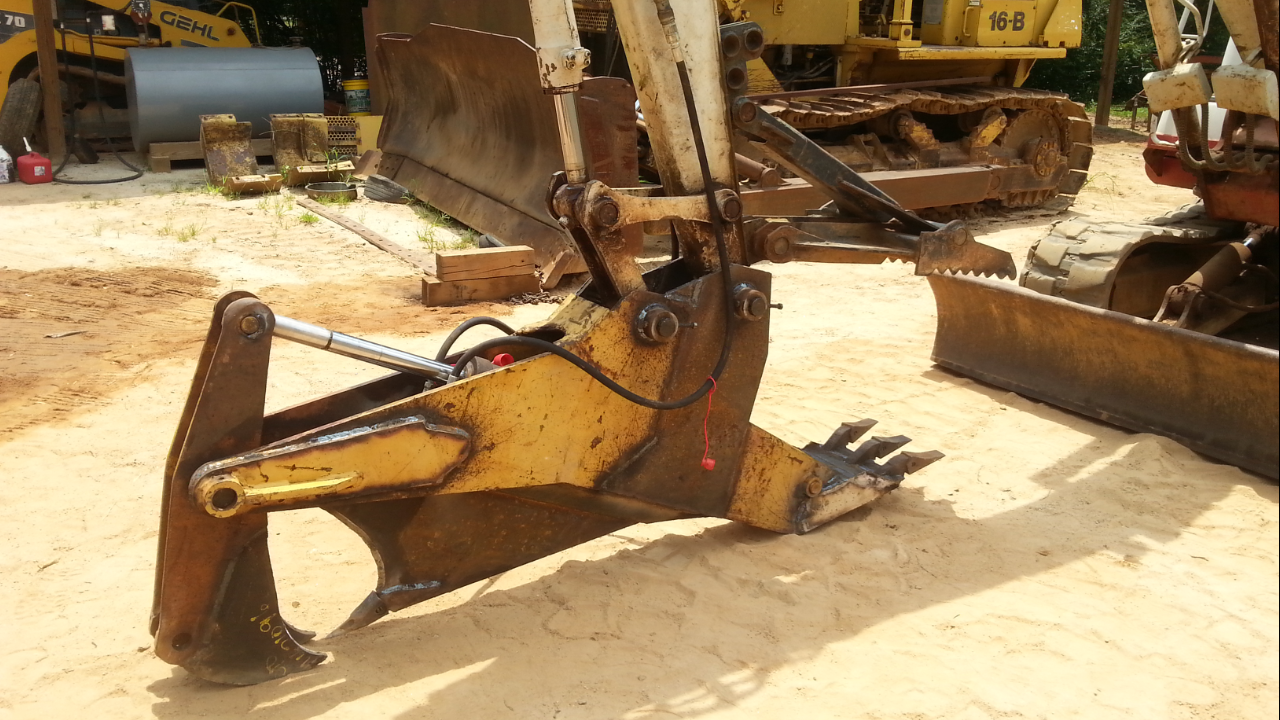

I bought my 655 with backhoe about 14 years ago. with a takeuchi tl140 and a cat 943 the 655 rest in the shop these days. Backhoe was in terrible abused shape when i got. I hoard steel and anything that can be used for later projects.             So the day came i could use it. Hoping to use with tub grinder and removing stumps. Not sure if my pic will load.

Cylinder goes to a link arm from a cat 951, same center pin (lucky me).

looks like it'll work!
