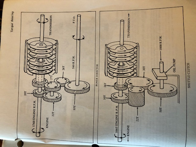

Here is a diagram of the power flow in the 621 forklift. The power train is from the D-15.

this is a page that I constructed by cutting and pasting gears and shafts from several pages of the parts book. I never did find the exact page with the shuttle clutch intermediate shaft and gears. This part is how I think it should work. Everything else is right out of the parts book.

I wondered how shuttle clutches worked. Once you see the concept (and wrap your brain around it) it is fairly simple really!
Thanks for putting this together Dean.

This is from the 615 Service Manual.
![]() The 615 is based on a D15 Chassis. Edited by JoeO(C-MO) - 19 Mar 2019 at 8:25am |

This is the Service Manual page from JoeO(CMO) after some tweaking.

Thank you Dean. That is the set up I remember from the D-14 shuttle clutch - just smaller. Sorry I could not be any assistance in your quest. Good Luck! Bill Long ps: You may want to include this in the Knowledge section. I am certain others want to know. Pop's Knowledge is Power book did not have this good a description for the power director
