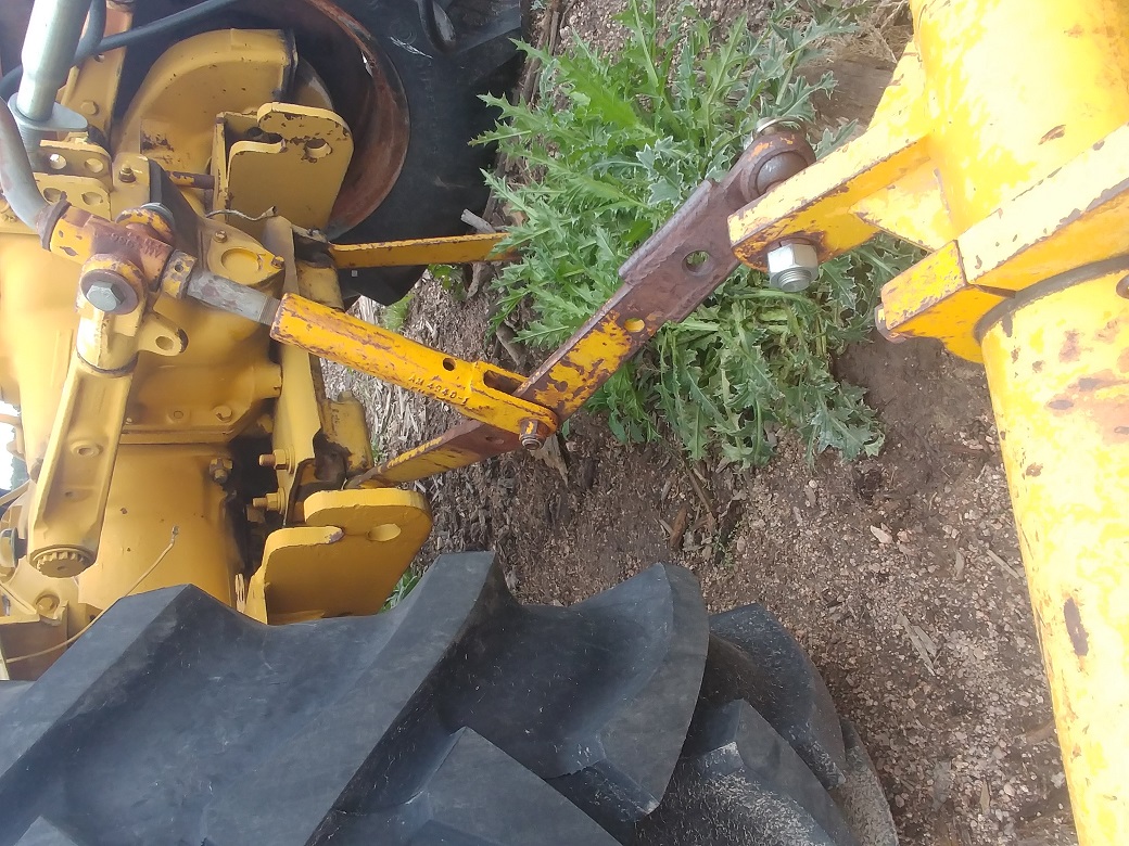

First off, welcome to the forum!  Just out of curiosity, can you post pictures of the arms?  I believe the arms are a simple straight arm, and will interchange with off the shelf parts, that tractor stores can get.  But having the picture here will spur discussion...

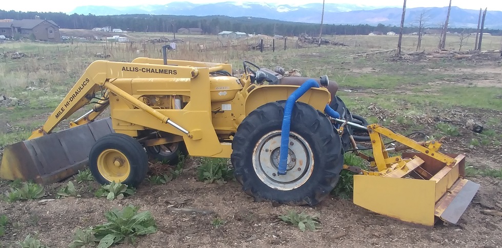

Thank you for the warm welcome DiyDave. I'll post a couple pictures. This tractor was literally the only thing I owned that survived a terrible forest fire 9 years ago that wiped out my property. The tires and hoses all burned off and she is scorched on the opposite side from the picture. new tires, hoses, oils, and bam! she fired right up! Big smile

Yep, looks just like the AG tractor 3pt. Not one of Allis Chalmers better engineered items. You'll be better off if you take the center to center measurement and try to find a generic pull arm. If AGCO would have a new part available you'll need a loan to buy a pair. That hitch will NOT tolerate turning with the implement engaging the ground.

As Paul said, measure the length of the arms, C to C, and where the lifting hole is.  Also make sure the replacement arm is not thicker than the lift screw ears allows to fit.  Also, crawl under, and look for 3 bolts that screw into the transmission housing, vertically, from underneath.  These 3 bolts (or studs or a combo) hold the whole shebang together, and have a nasty reputation of backing themselves out, when you least expect it! Be careful if you remove them for replacement, you may be in for an oil bath, I can't remember if any drain the compartment above...Wink

Thanks very much gents - greatly appreciate the help. I managed to find a parts manual and found the arms and original AC part numbers (left and right) - a lot of good that did me! (sarcasm...)

Both great tips Steve - I see a wide array of them on ebay. My measurements appear to be 32" overall center to center and 19" center (tractor side) to the lift arm hole. And I do understand the physics of the wider arm vs. a thicker arm that you pointed out, but I hadn't thought of that!

Did Allis keep the traction (draft) control on the 615?
Those big brackets are they for a backhoe?

Hello BrianC. Being a weekend type user of my tractor, I'm not all that familiar with draft control. I *think* one of my control levers will control/limit the height of the box grader (with separate control for the tines inside the box grader), but I don't believe it has a control that will control/limit the depth of the box grader. I'm sort of guessing here so I could be completely wrong about that.
As for the brackets, the 615 did have a backhoe attachment available and I believe those brackets are for that mount. I don't have the backhoe on mine (obviously).
