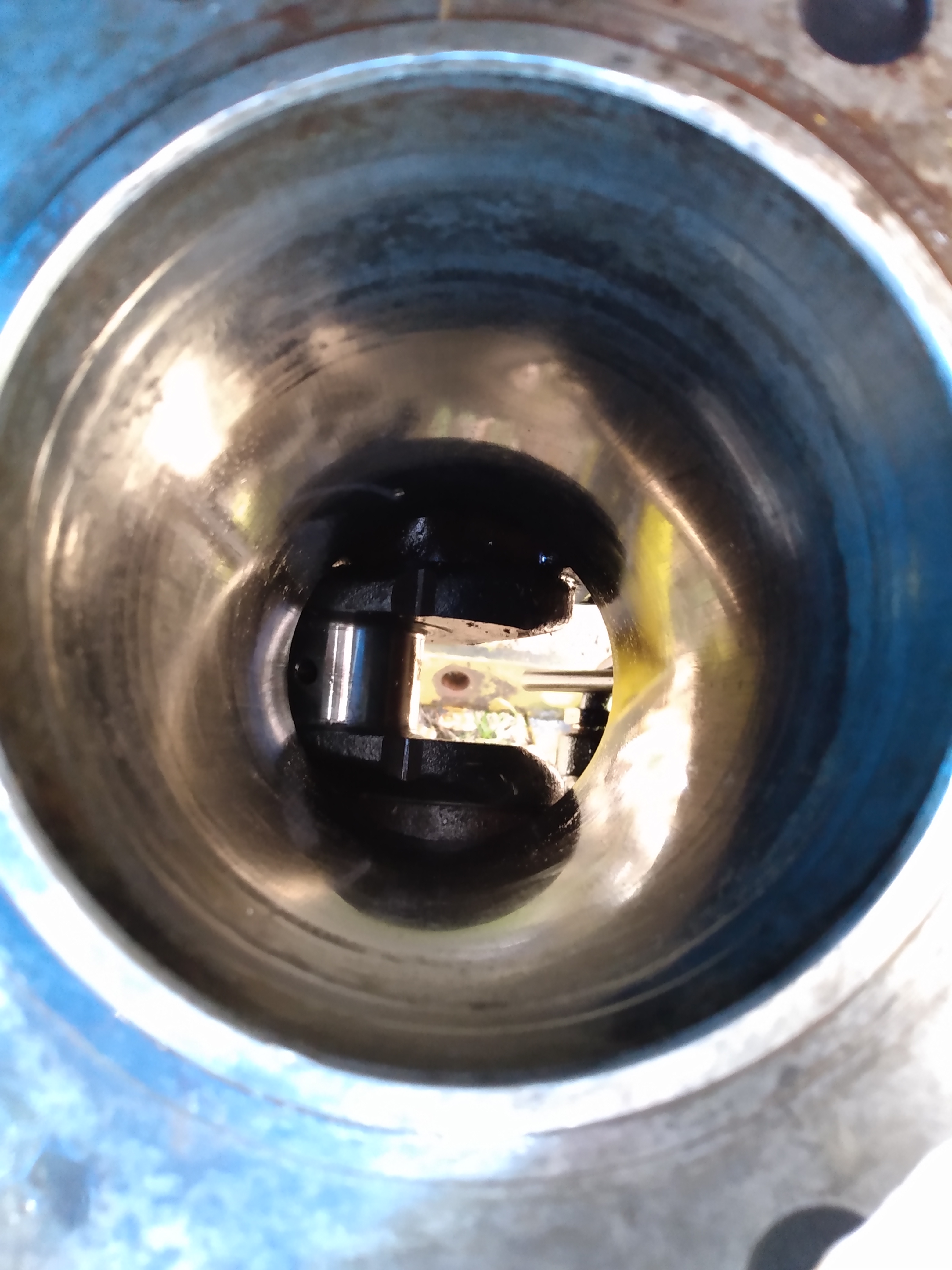

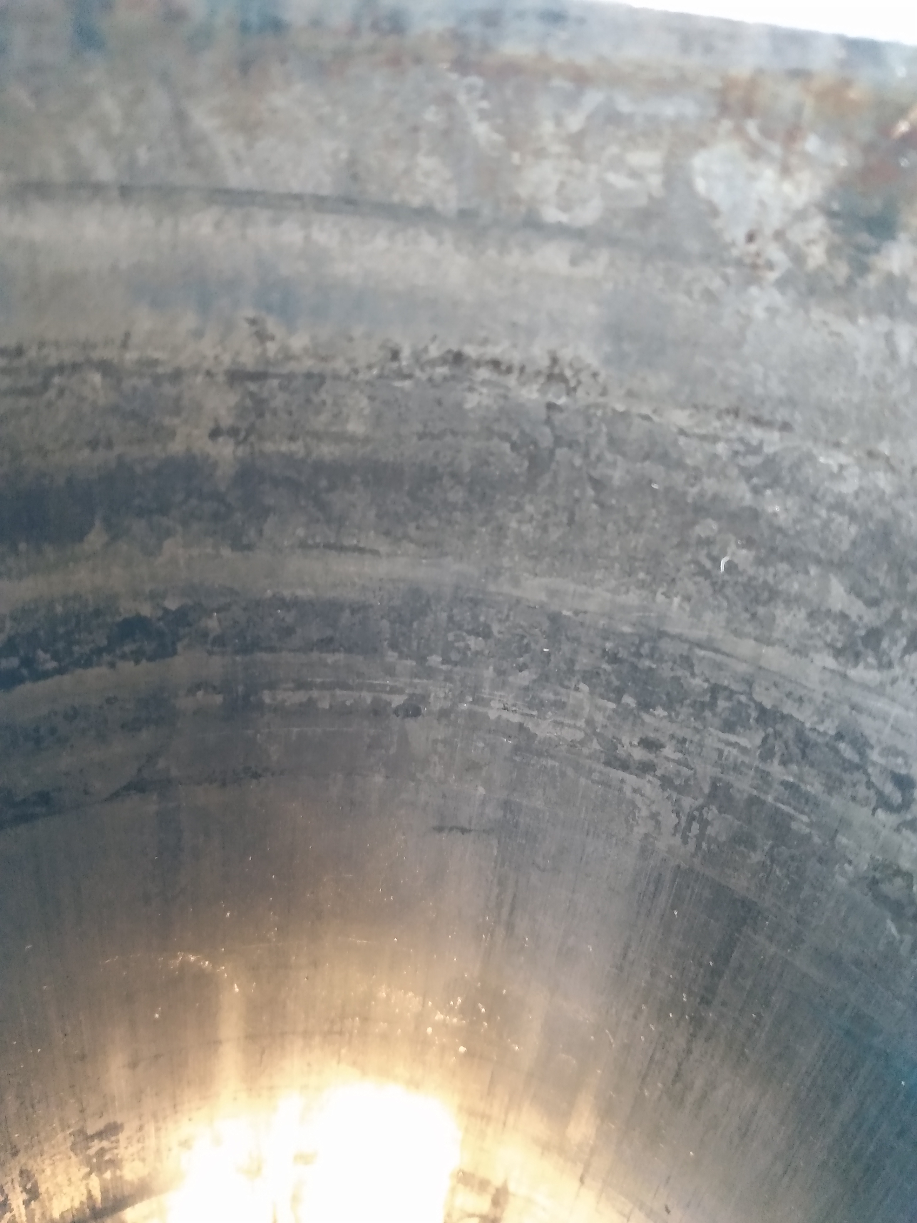

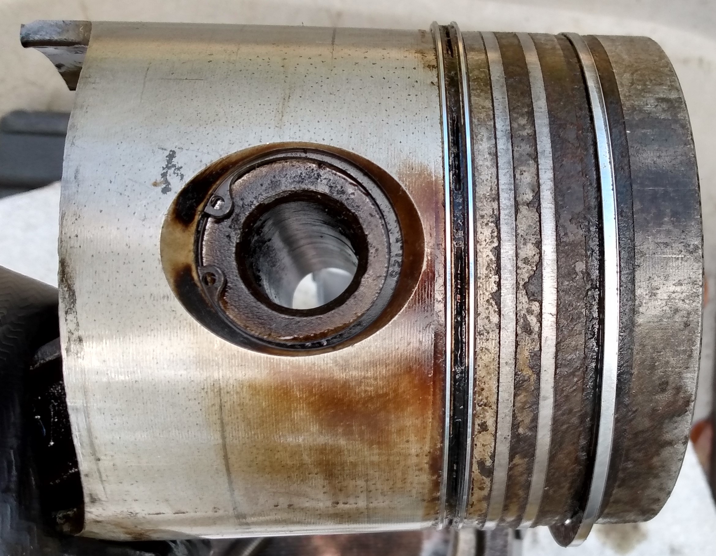

Thank you for getting back with me. I have pulled then Head have taken out the rear cylinder to get a look at what is going on. You are right the bottom in looks great. cylinder walls not so much where that sat and got water.
You are right about wanting to make it 100%. I have the urge but not the money lol in the army I would just order every thing and throw it back with all factory settings.
Here are some PICs of what i found on the inside. Plz if you would advice on what you see. My thought is it could use new rings sleeves and maybe rod bearings? NEVER re-sleeve a engine uploads/22571/IMG_20211103_123203702.jpg  uploads/22571/IMG_20211103_123218499.jpg

I guess I would have done a compression check before removing head as low compression could be valves also

Might be worth doing a ball hone tool clean up and just rings .

If all the pistons are about like the one in the picture they will be good enough once they are cleaned up. I can't quite make out details of the liners, how are the ridges close to the top inside the liners? What did the piston/liner clearance look like before you pulled them out. You could check the bearings with plastigage, my guess is the bottom end is OK the way it is.

The way to see if the bottom end rings true, is to invert the block, with the crank bolts still tight, and take a long aligning punch, smack each cap, like you are paddling a child, and if the punch rings, like a tuning fork, bearings are OK.  If you hear a "thock" instead of a ringing sound, that bearing needs looking into...Wink
If you have a ridge at that top of the cyl, try this:  Take a copper penny, drag it up the inside of the bore, from the bottom.  if the ridge cuts a shaving off the penny, it needs ridge reaming...Wink
