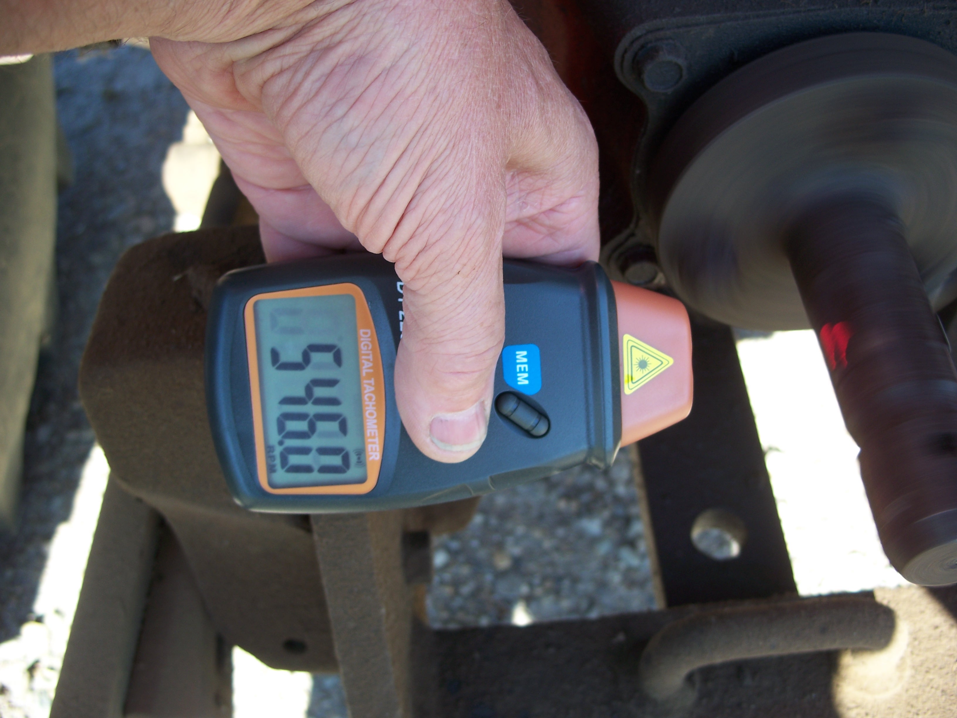

Good question so I thought I would get the 6080 out.  Here is the PTO at 546 RPM.

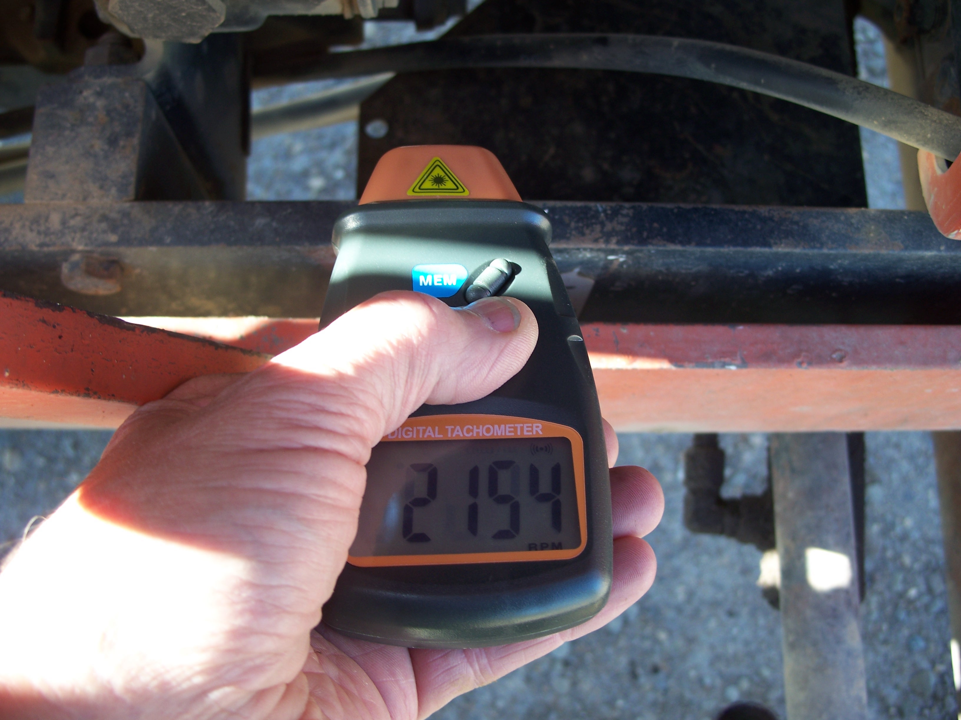

Here is the actual engine RPM.

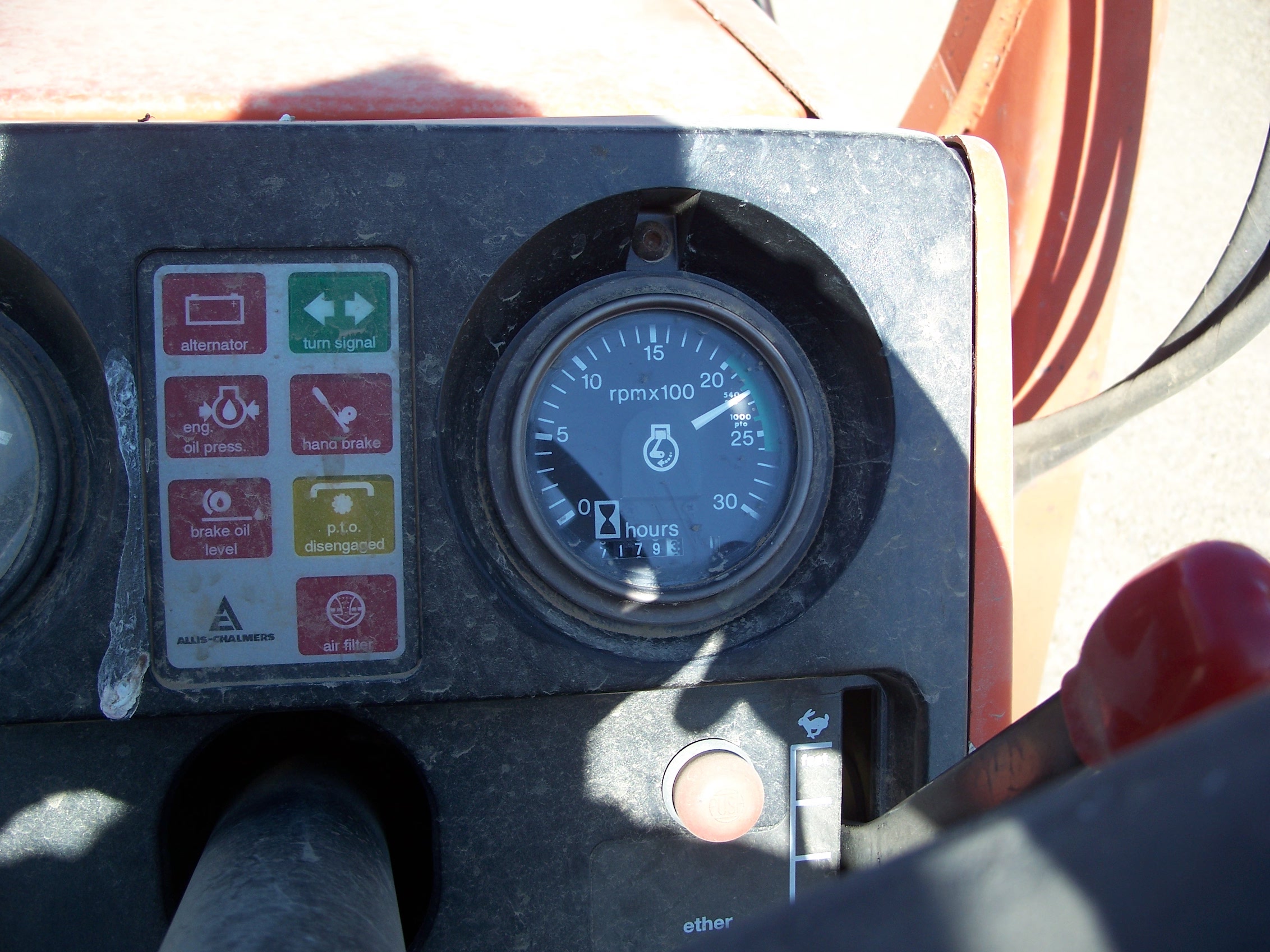

Here is what the tach says.  Looks like the tach is about 60 to 75 RPM's off, but pretty close.

Thanks for taking the time to do that. Looks like I won't have to run my tractor that hard to cut what I want with it which is good news.
